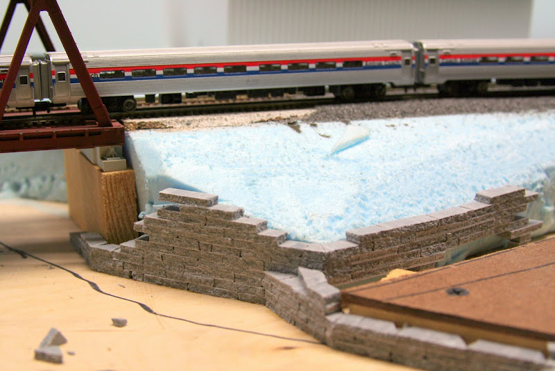

I did build similar abutments using "classroom" flooring tile. It looks okay in this picture, but I feel like I made the bricks way too big to be realistic.
That looks pretty good to me although the ledge the bridge end is sitting on seems pretty deep.  I would think the ledge might be just a couple of scale feet deep...just enough to accommodate the bridge bearings ("shoes" :) ).  And don't' forget to add those!
nice work
md
That's what I thought when it was done.  I did make this pretty early on in my return to the hobby, and just kinda winged it.  I suppose I could take another whack at it.  One $0.79 tile will provide enough blocks for probably 3-4 abutments.
