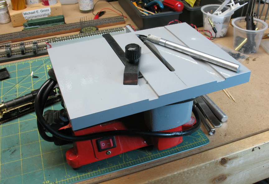

A couple of weeks ago, I picked up one of the these cheapie Harbor Freight jeweler's table saws at a train show.
(used, so it was cheaper than even at Harbor Freight).
I know from reading around the web that these are not well thought of, particularly because they
seem to have a grossly underpowered motor.
But I think people are trying to use it for heavier work than it was intended.  I wondered if one put a
very fine-toothed blade in it, could it be used for really thin, precise cuts in metal.
Ha!  It sure can.   I found a place online, Martindale Electric, that makes small fine blades for saws like this.
I bought a 4", .010" thick, 300 tooth blade.  It's like having a Zona blade in a circular saw form!   And it slices
cleanly through brass thick-wall tubing and heavy brass sheet (like 1/16" thick anyway), with no trouble.
As you can see from the photo, you can barely even see that there are teeth on that thing.  And it can make extremely
thin cuts because the blade is so thin.  About the only thing I think I'll improve is that I want to get some heavier
steel disks, perhaps about 3", and bolt them on on either side of the blade, so that it isn't
4" of .010" steel, which gets very floppy if you're not careful.
« Last Edit: July 03, 2017, 06:50:50 PM by mmagliaro »

MMAGLIARO Do you know if it will cut plastic without melting it? Thanks,Brian
