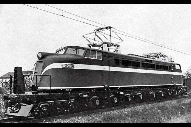

BTW, the Brazilian's gave the Joe's a very snazzy paint scheme, reminiscent of the New Haven -

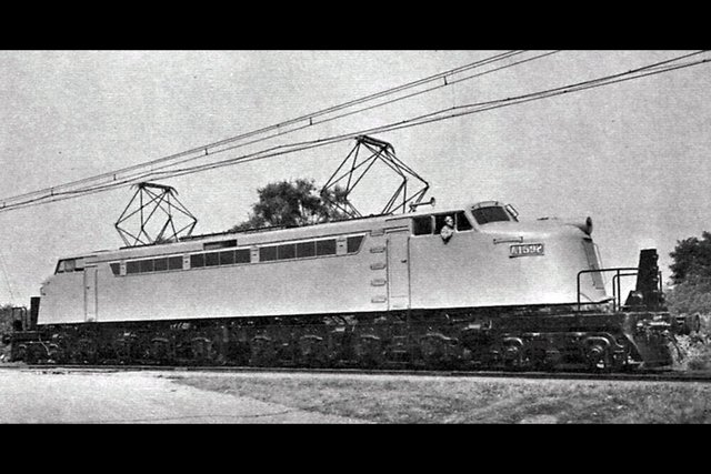

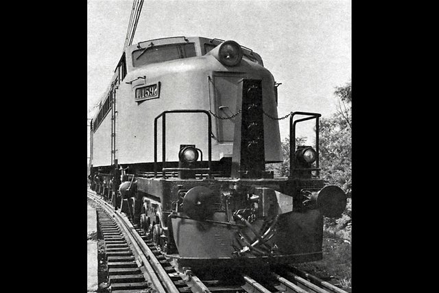

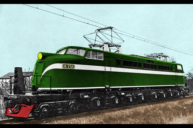

The General Electric EF4 as originally build, with buffers and Russian automatic couplers. In front the box to connect the cables for multiple drive. As far as I know, this was removed on the USA versions.
On the testtrack, with 1524 mm gauge bogies.
Black and white picture, which I have colourised.
(colours are speculative).

« Reply #10 on: January 05, 2024, 02:14:43 AM »
The MILW kept the MU towers, but many of the units were converted to single-cab, with new circuit breakers in the other cab.  Those only had the tower on one end, since there was no need for one on the front.  MU'ed with diesels the electric had to be the lead unit, and MU'ed with each other they were run back-to-back.  Avery and Deer Lodge had turntables for reversing them.  I don't know whether Harlowton had a table or a wye.
