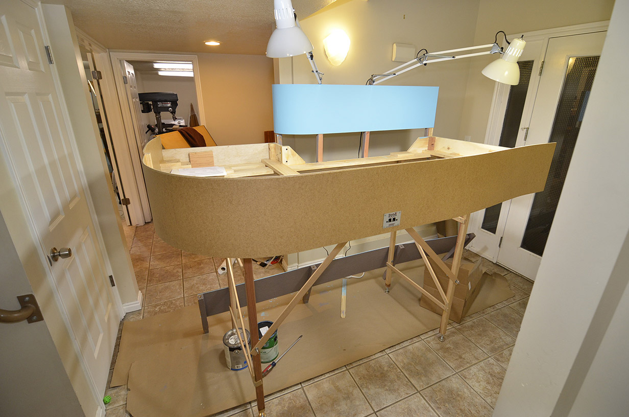

Skibbe...Hahaha...some of us are, but the modules are not heavy.  That photo is from an earlier design and the new standards don't use as much plywood.
However, the modules are not extraordinarily light either, but they're sturdy, stiff and "robust", and are designed to be easily transported by two normal adults.
I don't consider myself to be "ripped", but I don't have any trouble setting them up all by myself when I've got them in my train room fresh back from a show.
The premium pine L-girders and redwood balusters used on the legs is surprisingly light and nowadays we use 3/4" plywood only on the ends for strength, stiffness and durability at the stress point of where the clamps and big bolts are applied.
Here's a photo of an atypical "adapter" corner module that transitions from my buddy Gregg's older modules to my "standard" modules.  The fascia gets mostly cut away except for one big slice through a mountain where the curved twin Taggarts Tunnels on the UP pierce the jagged rocks.  No subroadbed has been applied yet in this photo but this gives you a better idea of the "airy" quality of the benchwork and folding legs:
New benchwork standards are basically just two premium pine L-girders with plywood ends.  The cross-bracing for attaching risers and for stiffness double as supports for the curved front fascia, but in 6' that's usually only from two to three redwood baluster cross-pieces.
I know you guys build 'em really simple and lightweight.  Ours are not so lightweight or simple, but the basic design has been in use now for nearly 20 years and works well for us, and is easy to use in atypical applications where an odd-sized irregular module is needed (because of modified legacy modules).
