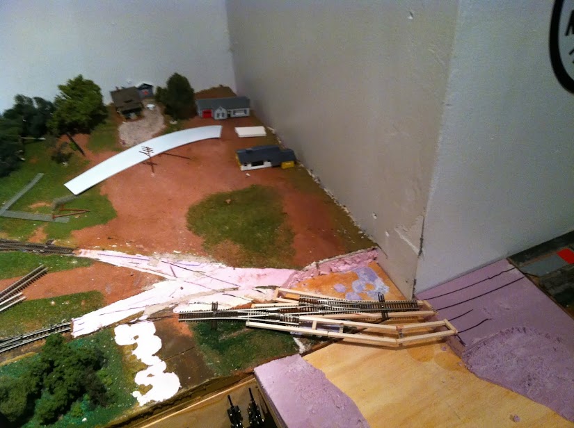

« Reply #70 on: October 25, 2013, 09:51:43 PM »
Well I haven't exactly whipped out trestles, but I do now have deck framing:
This will definitely hold the turnouts (!) in the design alignment:
I just need to add crossmembers in the frame and design a jog to build trestle bents from.  But I may yet get track laid so trains can run from the now functional yard to the rest of the layout!

« Reply #71 on: October 26, 2013, 12:55:52 AM »
With all due respect to Bufkin Bayou, I'm not crazy about the turnouts on the trestle.  Sure, Ed's Law will easily produce turnouts on bridges, but this example doesn't work for me.  Besides, how are you going to control the switch points?  Perhaps a culvert would suffice and you could model the bayou up front.
  • Posts: 16564
  • Respect: +7455
Re: Baton Rouge Southern - Chapter 2
« Reply #72 on: October 26, 2013, 12:34:12 PM »
I'm with Dave.  Either shift the turnouts down to the left to get them off the trestle, or do something else to manage the drainage there...
Also, I think your timbers are a tad bulky to have a scale appearance...
I'd go with something that scales out closer to an 8x12 timber, maybe 1/8th" strip stock.  Looks like you're using 1/4"
Also, the main stringers will be more in line with the rails, not outboard of them.
Tear it down and start all over!

« Reply #74 on: October 26, 2013, 02:36:55 PM »
Thanks for the sketches.
As you all heap up the Pile o' Peer Pressure on my options here, a few Given's and Druthers:
  • The alignment of the two switches is pretty fixed where it is.  As we have discussed up thread, if I can't get two left handed switches of sufficient length to move the crossover close to the existing yard throat, then the two right hand switches I have need to be where they are.  Otherwise, I get a torturous s curve going from the switch leads back to the existing refinery lead.
  • The Bufkin's Bayou is a scenic conceit - There aren't any bayous of this type between the Baton Rouge yard and the Exxon North Baton Rouge refinery in real life.  If I don't do the Bayou then I have to go prototypical and put in a bunch of low concrete block industrial buildings ala Lance Mindheim's Miami layout.
  • If I don't do a trestle, then I can do a couple of concrete bridges per KCS practices elsewhere.  That said all the bridges in Louisiana are creosoted pile types.
  • The switches on the bridge are not that hard to throw - I use Humpyard Purveyance throws which actuate via stainless steel wires in teflon sleeves.  I plan to run up the trestle bents on the back side, painted a control cables.  Add in all the cypress trees I will expertly make (!) and you won't notice it much.
