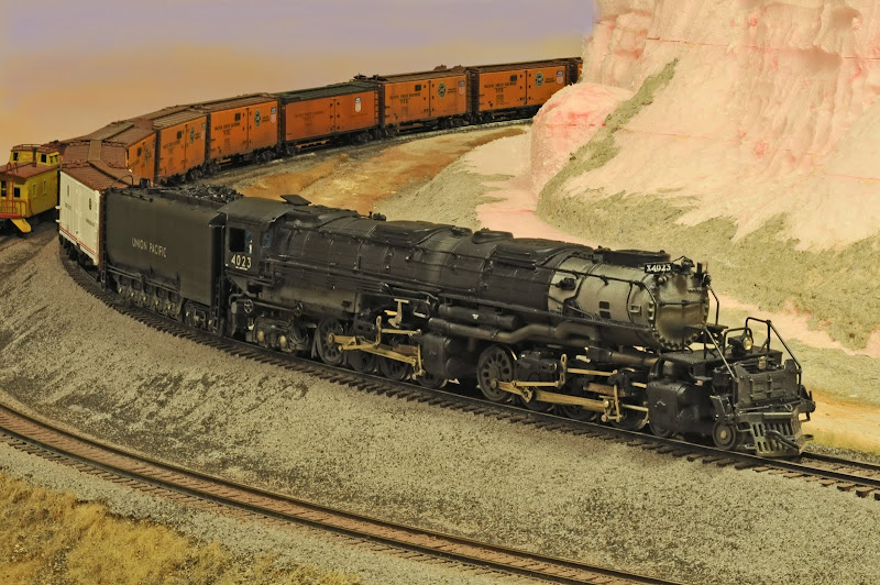

Here's a shot at Echo Curve with track done using this method.
