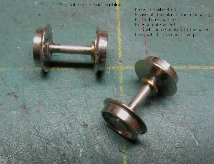

To close the loop on this, I ended up using  "Bare Conductive" brand Paint to get one side live on the existing wheels.
It works much better than I thought it would.   When wet, it doesn't seem to conduct for squat.   But once it dries,
there no denying, it works.  I can touch leads to a pilot wheel and the tender, and the engine runs just fine.

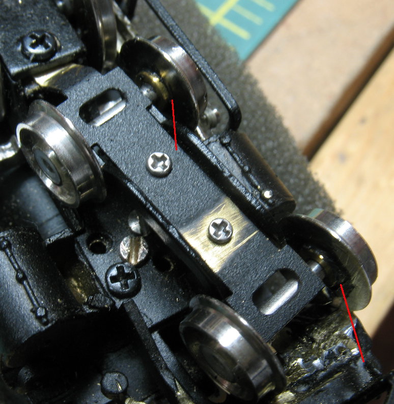

Photos show how I modified the pilot wheelsets so that the paint will be able to be on the axle, and on the wheel,
and all around the edge of the new brass washer, without ever coming in contact with the truck frame, which could chip it off.
A tube of the stuff only costs about $10 at Radio Shack.  It is not silver-based.  It is carbon based.  But it works.

Those are the original wheelsets that were in the Key / Yulim 4-8-4 I was repairing.  I used the brass washers and
conductive paint to convert them from being insulated on both sides to having pickup on one side.  So I did not
need to change them out after all.  I thought I would have to, which is what caused me to open this thread
looking for a replacement.

Max, what conducts the electricity from the now-conductive wheel?

Lemosteam: since Max's model is brass, all the parts of the truck frame and loco frame (and the screws) conduct electricity. It might not be the most reliable connection but it is better than nothing at all. Maybe Max will solder a piece of flexible wire between the trailing truck and the frame for better connectivity.
Max: why couldn't you just replace the nylon insulating bushing with one made of brass?  Even if you couldn't machine one with tolerances tight enough for tight press fit, you could have soldered the wheel, bushing, and the axle. That would have resulted in a solid connection (both mechanical and electrical).

The current flows from the wheel, through the conductive goo, to the axle.  The brass washer just reenforces the connection
and protects the goo coating.  As Peteski pointed out, everything is brass.  So current flows from the axle to the truck frame to
the main frame.
No, it certainly is not a "reliable" connection.  But it's better than you'd think.  There is enough weight on the truck to keep
positive contact between the axle and the truck frame.  The only flakey part is where the truck attaches to the main frame
with a screw.
But Peteski was right when he said, "It's better than nothing".  Even if,  from the whole pilot truck, you get a complete circuit only 50%
of the time, that is huge when you are battling the odds against a potential stall.  Even 30%.  Heck, that means that 1/3 of the time,
ALL the drivers and ALL the extra pickups on the tender wheels (which I added) can fail, and the the engine will still run.  Those are pretty good odds.
