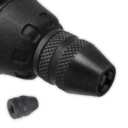

@cbroughton67 I haven't tried chucking anything in the drill yet, but do you know if the collets work with those small bits?
Initially, I picked up a pack of Dremel collets and used the smallest one. It worked pretty well, but it occasionally had issues gripping a #79 or #80 bit. So, I switched out the collet for a 1/8" one and use a mini-chuck I picked up either on eBay or Micro-Mark. It has a 1/8" shaft and does a better job of gripping a #80 bit. I'd like to figure out how to adapt a Dremel chuck to the drill - that would be the best option of all, IMO. I may have to try the pencil drill. I've never had issues with the pistol-grip Tamiya drill, and the idea of a pencil-grip setup sounds awkward to me, but I'm certainly willing to give it a try. @Lemosteam I hope you're able to find the link to the build for the screwdriver drill! :-)

@cbroughton67 , I did , but @up1950s s pictures will not display any longer and most of the banter ther is rather esoteric.
What I did was I found an inexpensive 1/8 hex x 1/4 hex bit and chucked the 1/8 side into my drill press and filed the corners of the 1/4 hex.
https://www.amazon.com/Irwin-Tools-92423-Insertbit-585-92423/dp/B001HWNPRU/ref=sr_1_31?s=hi&ie=UTF8&qid=1505532029&sr=1-31&keywords=1%2F4+x+1%2F8+hex+bit
After rounding the 1/4 hex just a bit, testing fit to the hole in the chuck because I wanted a light fit, I pressed the 1/4 end into the this chuck with some epoxy for good measure:
https://www.amazon.com/gp/product/B0047WPAMU/ref=oh_aui_detailpage_o02_s00?ie=UTF8&psc=1
The General drill is a 1/8 hex socket on the end of the output shaft so I simply epoxied the chuck/bit assembly into the end of the drill  the flats on the hex allow for a 1/4" open end wrnch if you really need to tighten the knurled chuck.

Yeah , when Google took claim to my photos and jumbled all of them and with no sort by description it pissed me off enough I made all my albums private . It would take a year to straighten things out and even then it would suck . If you can't sort by description it like throwing pictures in a barrel which is useless to my needs . Anyhow , here is the shot of that great for plastics when using itsy bitsy tiny weeny bits .

With such a long shaft to the collet, is there any problem with wobble?
If there is, I'd be worried of drilling a #70 hole with a #80 bit.
At its slow RPS ( about 3 ) it works well enough for me . Yes there is wobble , quite a bit , but its my best for gnats a$$ sized holes in plastic I have ...... so far .

This might be the answer to my Tamiya Handy Drill chuck dilemma...
Chris
@cbroughton67 I think they make a 1/8 x 1/8 as well.
