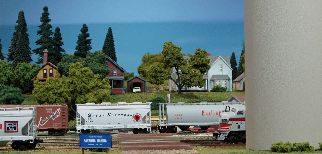

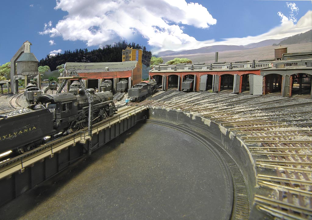

This is definitely a stacked Helicon image:
In the lowest right corner you can see some halo effect on the rails. They were too close to be in focus at the nearest focus setting.

The depth of field in this shot is probably 3" to infinity, in this case perhaps 12 feet. The close-in slices were shot a f/22, to make the closest objects as much in focus as possible; the remaining slices were at f/8.

This shot would be impossible without Helicon:
As I was on forums other than Railwire for a long time, I suspect many of you haven't seen most of my images.
That is a jaw-dropper.

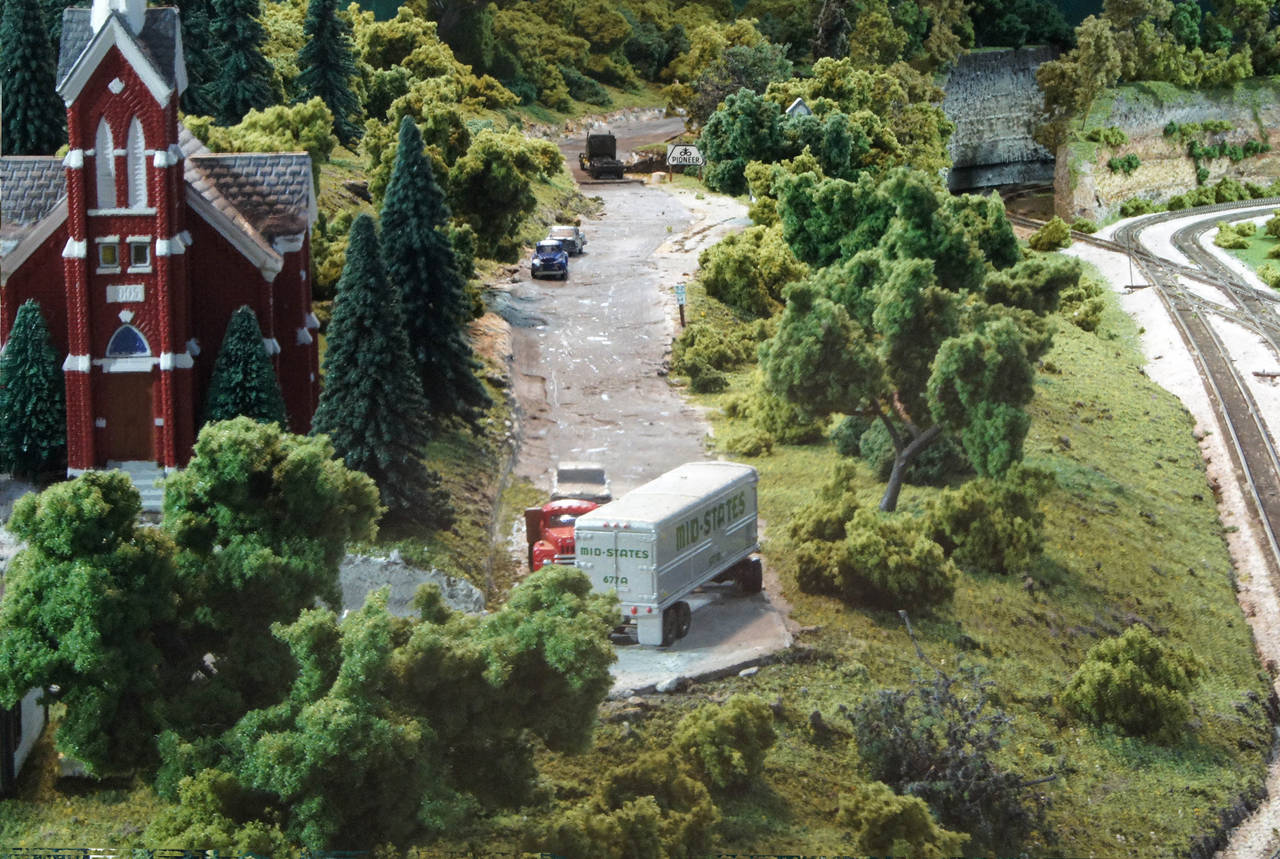

And Helicon (and the others) works very well with longer telephoto shots:

I have been experimenting this afternoon, with using some longer f-stops for the closer shots and f-8 for the deeper ones, as well as with various processing sequences.  What seems to be working best so far is to align, balance and then crop all of the pics to be stacked, before doing the stacking so that the program is only working on the interesting parts of the images.  So there are elements to both art and science in this focus-stacking business.  Beyond that, I think I need to improve my photography skills!!
Nothing happening at Galena Jct. today...oh, wait, I see a southbound coming!!
Looking uphill from the marina at Savanna
Heading east out of Savanna on Ill. 64 will take you about an hour to reach Oregon.
