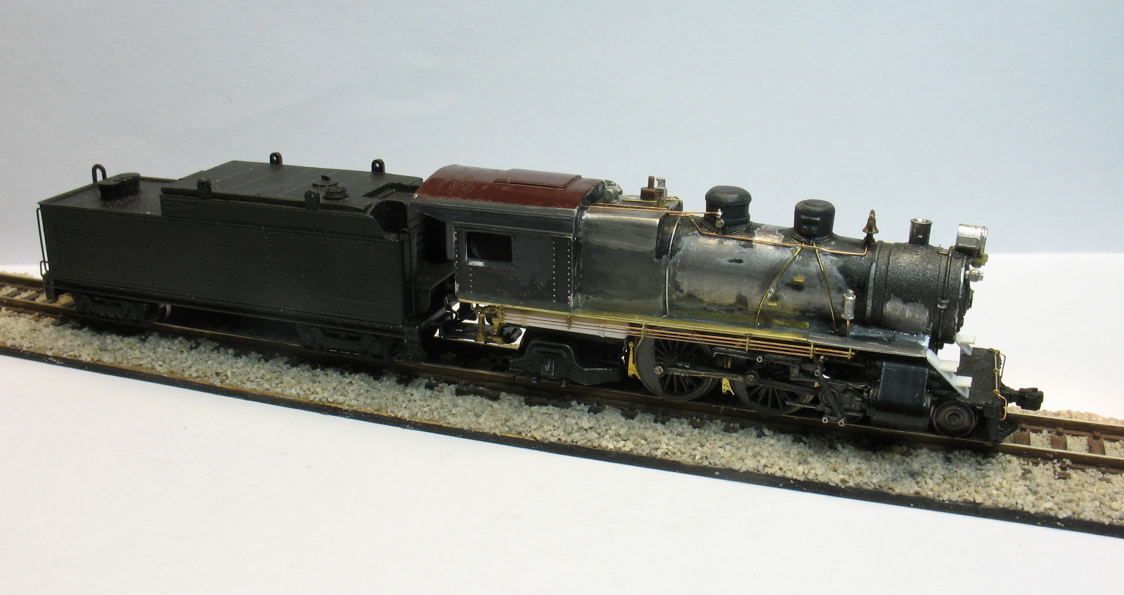

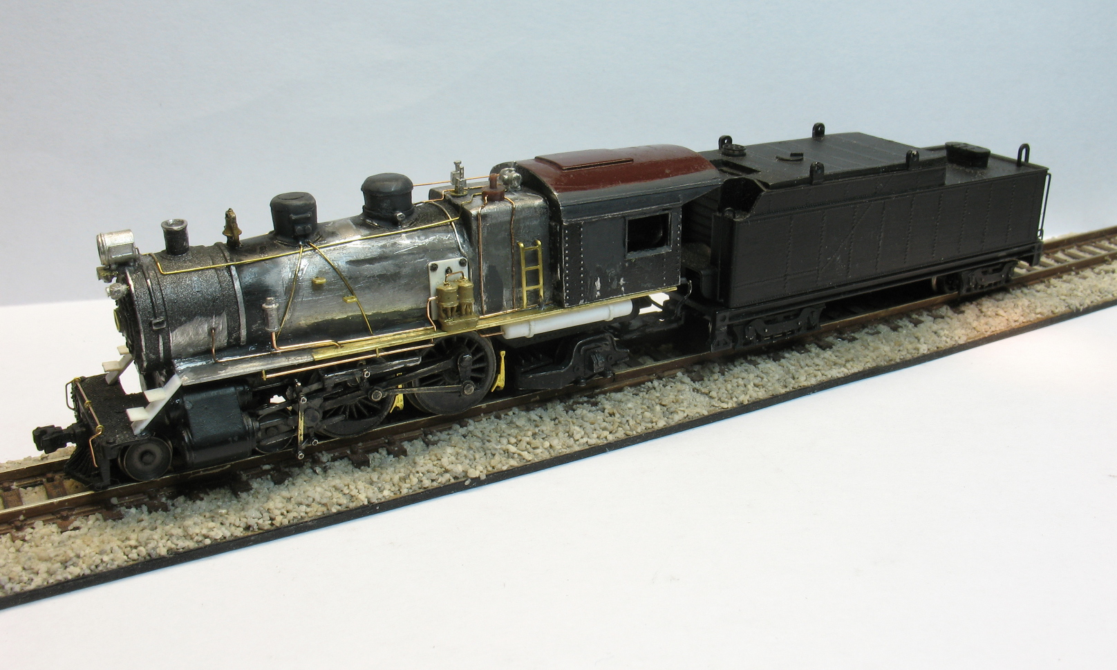

Got all the lines and piping on my 4-4-2.  I re-made the blow-down muffler (the little brown disk thingy with
the pipe coming up out of it, on top of the firebox, just in front of the cab).  The first one was too big.
I also noticed that the cab roof still had the traditional Pennsy angled rib, about 1/8" up from the cab window.
I filed/sanded that off and put a new rib on there with .005" styrene that I shaved off a sheet, so it's about .005 x .005.
I've also been putting a little dark gray paint on in a few spots with a brush, just so I can make sure I have things smooth,
and they'll look good when I go over the whole thing with an airbrush.  It's really hard to tell, with all that shiny
pewter and brass, whether things are really straight and smooth.
The handrails are the last thing to put on the boiler.  Then, it's paint, and some curtains on the back of the cab
to hide the motor.
But today, I started shake-down runs, so all the detailing work will stop for a while until I get it back to running
right again.  I have an annoying short somewhere (on left turns), most likely from the Fox Valley wheelsets in the pilot
truck (or maybe those brass brake shoes, hmmmm).   I think I've got something stuck in a gear or axle, too, ... it intermittently exhibits a kooky "hop"... could be a piece
of valve gear catching on something... Anyway... I'll be working on those issues first.

« Reply #51 on: November 26, 2012, 08:47:29 AM »
Max , crispy clean , looks great , are those the new pipe hangers ?
Yes, those are the new hangers.
