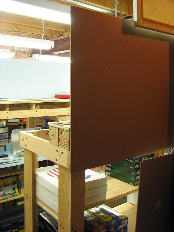

Jeff, I am enjoying the pictures of your layout. Very nice work. If I might enquire about your background construction details, what is the height and composition and most of all how you chose the height? Thanks very much.

Thanks Wayne,
I used 1/4" hardboard in 4'x8' sheets. Had it ripped in half by Home Depot so they were 2'x8'. So with 1"x3" benchwork + 3" from bench work to track = Backdrop 18" tall. Then i just screwed the hardboard to the 1x3 bench work and it holds up great. Back drop has been up for a year now and all good so far.

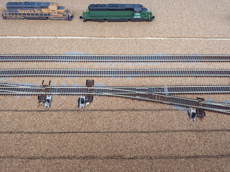

I have named the layout the CP Flog Subdivision and also have trains moving.
Here are some updated photos.
First the City.
The track

Well I have been working on the layout a lot lately but haven't posted much in updates, so here is a small update.
I have been running train to test the track and so far i have had 0 derailments, knock on wood  :scared:
Now i have started to install slide switched to control the turnouts.
