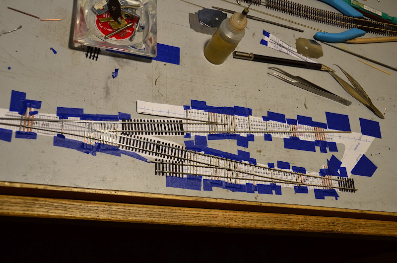

However, and I'm going to capitalize this...YOU DO NOT NEED EXPENSIVE FAST TRACK JIGS AND FIXTURES TO MAKE TURNOUTS. Everybody got that?  I've never used any fixtures, just my Dremel, my flush cutters, my bench grinder, two thin metal straight edges, a small assortment of files, a couple of pairs of pliers and tweezers, Railcraft 3-point gauges, and two NMRA N-scale clearance gauges.  Oh...and an old 30W Archer soldering iron with a wedge tip.  Except for the Railcraft (now Micro Engineering) 3-point gauges, you've probably got all of the above at your workbench or in your garage.
I use downloadable (for free from Proto87stores and Fast Tracks) turnout PDF's, printed out on my Epson printer at 100%, cut them out, tape them to a flat 1X4 about a foot long, and go to work.  Nobody needs expensive jigs and fixtures to roll your own turnouts (am I repeating myself?).
All you have to know is how to cut and file rail, how to solder, and how a turnout works.
If I don't group a bunch of turnouts together (I like to do that) into a monolithic unit, I can build a #8 code 55 in about an hour.  A little less for a code 40 and I don't build code 70 turnouts any more.  Since I bought all of my materials years ago, they cost me about $1.25 each.  If you buy all the materials today, they're gonna cost you about a dollar more per turnout (and...if you don't use expensive jigs and fixtures).
Here's a photo of three code 55 turnouts (built as a monolithic unit) being built by me on my paper template...one #4wye and two #8's...
