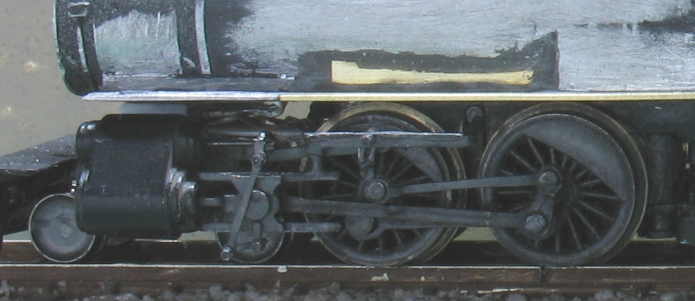

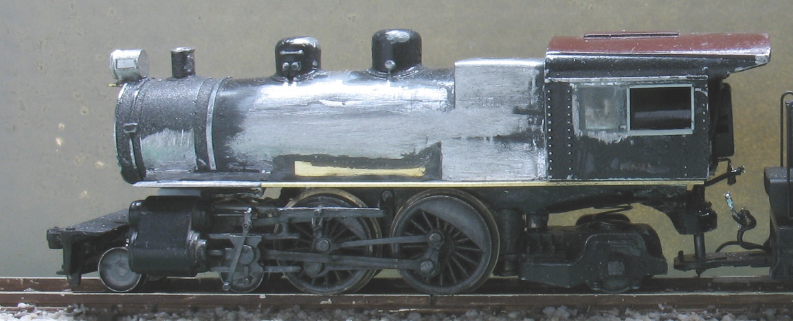

Well, I spent hours and hours shaving, drilling, and making valve gear parts for my SP&S 4-4-2.  Here is the first side.
And yes, it all works smoothly.  Those micro hex rivets really did the trick.  The rest of the parts are a mix
of brass strip filed and drilled by hand, and various scraps left over from my TrainCat etched brass bridge, and
the GMM Steam Loco detail sheet.  I'll be on a business trip for a week, so this will have to sit for a while.
It's pretty grueling work.   It's hard to imagine the old Rivarossi valve gear on it without looking at an old photo.
Have a pleasant week, everyone.

MAx, that Neolubbed valve gear looks mighty fine (in both meanings of the word)!  :D
