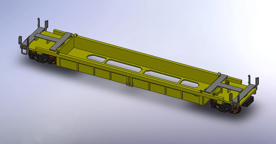

« on: September 29, 2012, 11:20:29 PM »
I need some variety from strings of MTL Huskystacks... so here's a shortened (48ft to 40ft well) Thrall built well car.  I sent it to shapeways to get a confirmation model in hand, but I'm thinking this will eventually go through the lost wax brass process to produce kits like the AAR flatcar.  Walkways will be etched.
Thrall also has 40ft articulated wells... it will be easy to do that version as well now that the main body is comlpete.

Re: Thrall 40ft Well
« Reply #3 on: September 30, 2012, 08:26:20 AM »
N scale too, while you're at it!  But definitely metal.
N doesn't have these yet?  If that level of detail is OK I can probably scale it up.  Are you OK with the walkway support blocks as-is?  They arn't the separate legs of the prototype, but the blocks will cast better.

Here I am minding my own business in the Z scale section...  :facepalm:
Tell you what, I'll make the changes to the solid model to adapt it to N scale, throw it up on Shapeways, and one or more of you can order the model and provide feedback.  I'll change the supports to work with the GMM detail set.
If someone wants to measure inside the folds on one of the GMM end platforms with steps, maybe we can save a round of iterations.  What trucks do you guys want me to size the bolsters for?
After the model is dialed in I'll get some prices for brass or pewter castings.

It's hard to get a precise spread distance with just the flat part.  It's hard to tell exactly where the fold takes place.
I think I've got a Walther's thrall somewhere... I'll measure across the end instead.
