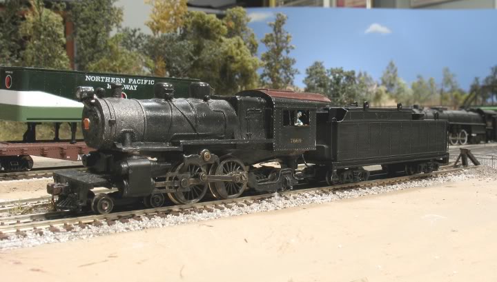

Since these were GN styled engines, they have Belpaire fireboxes, like the Pennsy.  So here is the "victim" that is going to
be converted, a Black River Locomotive Works PRR 4-4-2 E6.
Please.... my PRR mates out there, try not to hate me.
These were built out of pewter with Rivarossi/Atlas parts back in the 90s.
Not many were made.  I put a coreless motor + 4:1 gearhead in it years ago.  It runs wonderfully.
There are lots of cosmetic changes to be made: angling the cylinders inward, domes, stack, piping, cab changes, and
filing off the cast-on detail to be replaced with separate wire.  Remember, this puppy is 1990s vintage, so it needs
updating to bring it up to modern standards of detail.

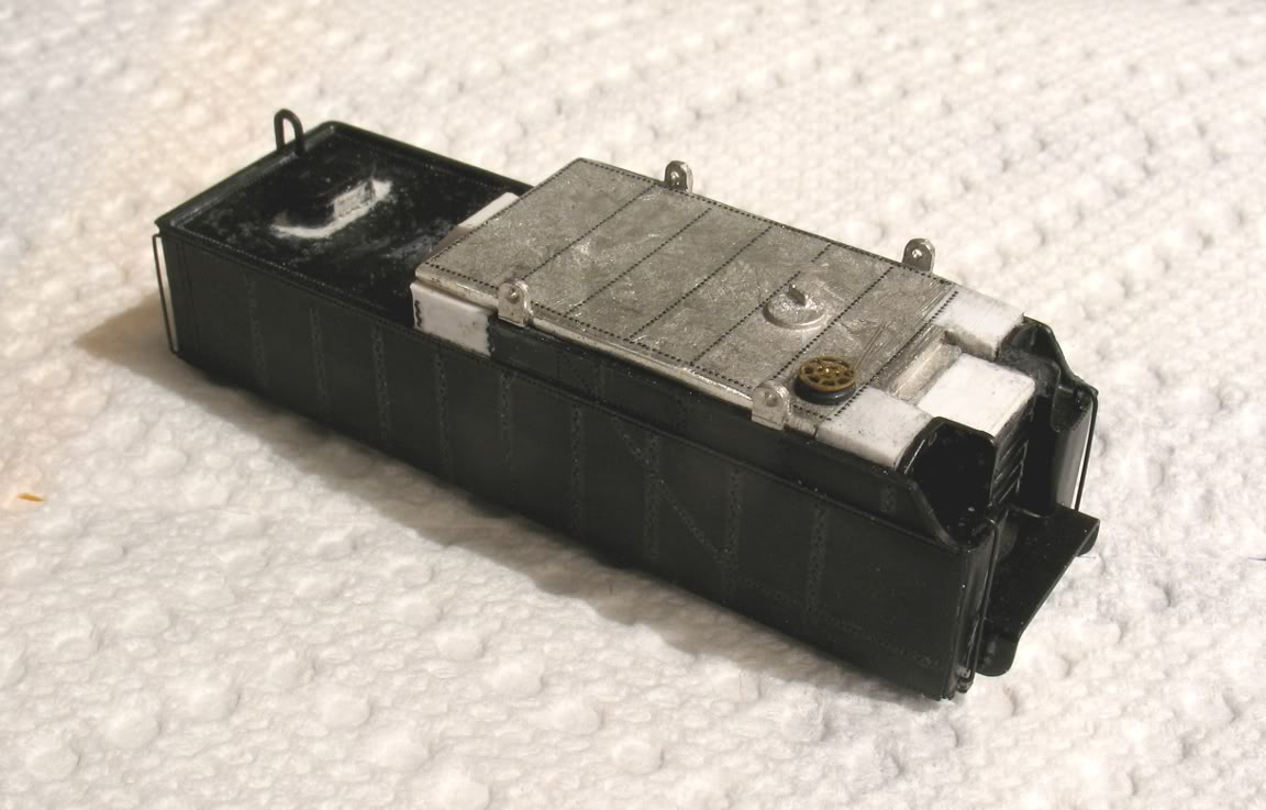

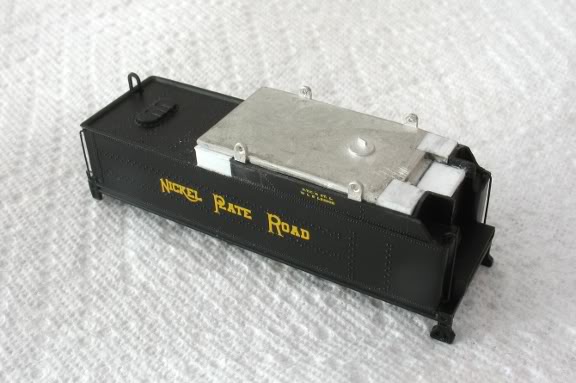

I am starting with the tender this week, which is a project in its own right.  It is a fairly long, large, oil tender.
I started with a Spectrum USRA Long, because it is about the right size.  I put in a GHQ oil bunker, with styrene extensions
to get the approximate right length.
Sand off all the rivets and replace/add Archer rivet decals to get the correct rivet pattern.  Raise the water hatch up on
some scrap styrene.  Bits from the junkbox, including a brass brake wheel, make that brake-wheel-looking thing in the corner
of the oil bunker.  I don't even know what it is.  But in photos, it kind of looks like that.
Quick shot of black paint, and there ya go.
I got the drawbar altered and the wiring run through, so now it's half PRR and half SP&S.
I think I'll be lowering it on those trucks.  I never noticed how high those Spectrum tenders ride... gee whiz.
More to come as the work continues!

Ax it's good to see you are "all in" with the SP&S!  That Pecos River model was too small for even the smallest PRR E6 anyway.  Nice to see you hacking and whacking again.  Maybe that will kick me in the pants to finish some of my projects and start some more!
Looks really nice so far, and I'm impressed with the rivets.  That's a big change in the looks department!
