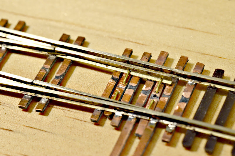

Here's what was on my bench Friday and yesterday.  They get installed today on my Emory center siding modules along with three more on the other end, as well as a single curved app. #8 for the trailing point siding there on the East-bound track.
Under construction
Finished except for non-PCB ties
Close-up of closure points
I'm using Andy Reichert's Proto87 Stores "tri-planed" closure points and etched NS closure point hinges for these turnouts to test 'em out.  Gotta say that the good ones worked very well...but...there were two sets that weren't machined properly and I had to do a lot of filing to correct them.  Also, the stock holes Andy drills in them are for HO scale, so I had to drill my own holes for the "throwbars", which was no biggy.  Now, I've got to fill the stock holes with solder before I install them.
Also, Proto87 Stores etched N-scale "throwbars" don't work for me, so I manufactured something similar out of .015" brass wire, which I think will be more durable and hold the tri-planed closure points in a correct position and look just as good or better than Andy's etched parts.
I'm looking forward to cutting these in on the double mainline later today!
Cheers!
Bob Gilmore
Very interesting Bob!  WRT the last pic, may I ask a few details:
 - What is it about the hole/wire method that you prefer over just soldering the point rails to the throwbars?
 - Can you elaborate on what aspects of the plastic P:87 throwbars didn't work for you?
 - It looks like in the points area there are several PCB ties that may not be needed and still the area would have robust construction.   Seems all you really need are the headblocks and the one tie under the ends of the closure rails.  Did you have a specific reason for using this many PCB ties?
 - I thought the machined P:87 point rails didn't require notching the stock rails (like the proto).   In this pic it looks to me like the straight route stock rail is notched, and also has one of those 'step' bends in it.   Did you find these necessary to make the P87 points work?
 - Are you using jumper wires or anything else to power the point rails?
Thanks,
