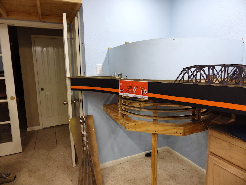

2. Paint the fasica, the idea that Jeff and I had was to paint the fascia black with and orange stripe. I have to say,,,, I think it came out GREAT!!!!! Not too much,, but just right. Adds some serious POW to the layout.
 You can see in those pics,, that some of the control panels are pretty close to matching and that some are off. I guess Kinko's had to throw a kink in there.lol
    Another task that was required was the programming of the consists that will power the multiple trains for the layout. Some decoders gave me fits, some worked like a champ. More towards working like a champ. I do know that NCE decoders gave me a major headache. It seems that once a consist address is programmed into a NCE decoder it " forgets" the original loco number, so I had to reset CV 19 to 0. And then the decoder amnesia was cured. So after 26 consists and 71 different locos. I was done with programming consists, till next time.
  Another thing that had to be done, was finishing the painting of the track. That means all track that is visable. The last area that needed to be done was the area in front of the helix and then the liftout section also.
  Yes I know the fascia is not cut out for the canal yet, hey rome was not built in a day either.lol
