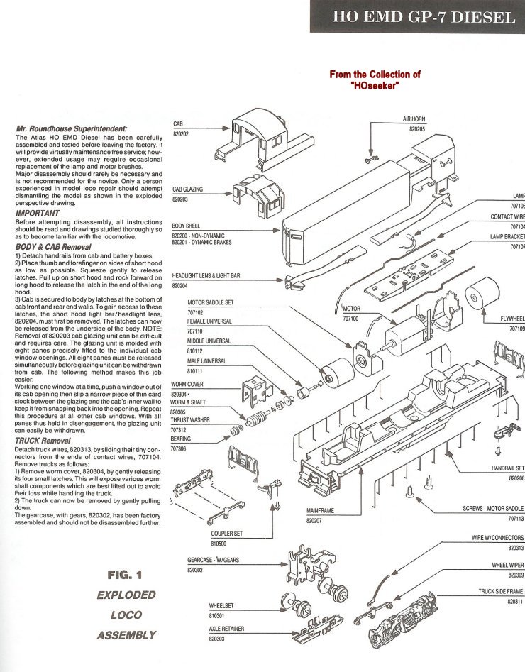

http://www.hoseeker.net/assemblyexplosionAtlas/Assembly%20Explosion%20Atlas%20GP7.jpg
^  Is that the right diagram?
Regardless, converting any engine to DCC is relatively simple.  While there may be a decoder designed to work with that locomotive, you'll be doing much of the same sort of work regardless of your choice.   Isolate the motor, connect it to the Orange and Gray wires of the decoder, then attach the wires from the track pick ups to the corresponding Red and Black decoder wires.
Packer's idea seems sound.
