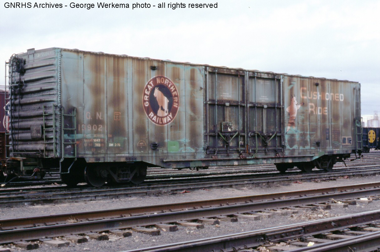

Does anyone know which railroads used this boxcar? I really don't need any Canadian roads.
I believe this is the same car as the Great Northern had, shown in the photo linked to below...
http://www.gn-npjointarchive.org/GNWerkema/GNRHS.Werkema.665.jpg

This GBW prototype and the GN prototype above appear to be riding on 36" wheels:
http://www.greenbayroute.com/1963gbw206.jpg
Looks like NKP and EL had them.
« Last Edit: May 01, 2012, 04:05:11 PM by bbussey »
  • Respect: +1737
Taking a closer look at the GN Prototype, it looks like it's sides are of welded construction and the car possibly built by ACF if the logo is what it appears it is.

Great Northern's 60 double plug door boxcars series 139000 to 139049 were made by ACF in 1963 to 1964 with 36 inch wheels and cushion underframes. The GN car looks very much like the cars in the RMC article. --Brian
