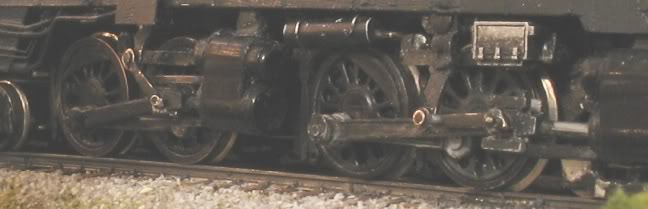

Looking at that stretch of real track, and the darker gray you are looking for, I suggest NeoLube (which you can buy
from Micro-Mark, among other places).
It is just an alcohol/graphite fluid, so you can just brush it on.  It is conductive, so be careful around any switch or other gaps.
But it's watery thin, so you will not likely create any shorts with it.
You can paint a LOT of rail very quickly and easily with it.  And because it's more of a "wash" than a paint, the finish isn't perfectly uniform ... another plus for doing rails.  It won't really stain plastic ties, but it sure will stain wooden ones or ballast, so be careful to just run a small brush along the side of the rail.
I always liked the result and will be using it again on my new layout.
Here's how it looks after it's applied:

1. Yes, you could use it before ballasting the track, however, since it really is an alcohol wash, I think that the water and glue
used during ballasting would probably wash some of it off the sides of the rails, so you'd have to do it again anyway.
2. When I get some on the top, to be honest, I just wipe my finger over it before it dries and it comes right off.  But once in a while,  some does get on there and dries.   Some rubbing with a paper towel will get it off.  If it's really stubborn, 800 grit sandpaper will polish it off without making the top of the rail rough.
Neolube is "pretty" durable, but it's not like paint or chemical blackening.  So it works pretty well on the sides of rails and on
steam rods and details.  But for surfaces that have to stand up to repeated handling and friction (like wheel treads or flanges, or the tops of rails), it will eventually wear off.
