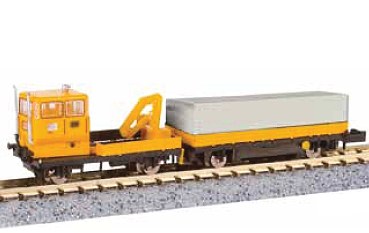

« Reply #29 on: May 01, 2012, 12:50:52 AM »
While not a rail grinder, there are some other cool MOW cars available in N scale:
and
Price is a bit steep but those would make a nice obstacle in an operating session on any layout.  Both models are powered. I have the Plasser tamper car and my long term plans are to install a DCC decoder and headlights/flashing beacon in it. The project is about half finished but as with most of the projects, it is in limbo while I Istarted yet another project. This is the story of my modeling life.
