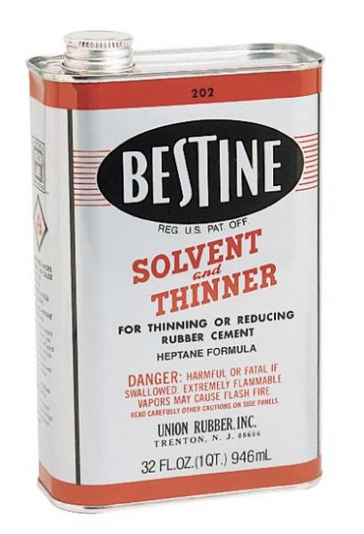

If you soak the models in Bestine for a day, the wax totally dissolves and you won't have to scrub and risk damaging the model.  The EX2000 material turns opaque white (totally) when fully void of wax.  See my gondola before/after comparison up-thread.

This stuff?

This stuff?
Yes.  It's Union Rubber's brand name for heptane, which is the actual solvent that dissolves wax.  Any pure heptane product will do but this brand is the most accessible.

Bryan,
Do you have any experience that indicates how often you can re-use the same quantity of Bestine, or do you use fresh material for each model?  The stuff is rather dear here in Canada.  My local Michaels here in Vancouver has a blank spot on the shelf for "rubber cement thinner" at $24.99 plus tax for 500 ml (16 oz).  Curry's art supplies in Ontario sells the same quantity for $9.95 plus $12.00 shipping to BC.  After taxes are paid, it is still 12% less expensive to have it shipped from Ontario.  At those prices, I would like to get as much mileage from the stuff as possible.

Bryan,
Greg,
I keep it in a large sealed glass container with a screw top, and put the models in that.  It doesn't get contaminated, as the dissolved wax adheres itself to the exposed glass and underside of the lid.  So you can continue to use it over and over.  One of the downsides to heptane is that it evaporates very quickly, so you want to keep the container sealed at all times other than putting the models in and taking the models out.  A glass French Jar with the glass clamp top would give a tighter seal, but I don't know what the heptane would do to the rubber gasket.  I've had my jar filled for two months and haven't needed to top it off, so a good screw top seems to work fine.
Also, check Amazon online.  You might find it cheaper both price-wise and shipping-wise than at Michaels or Curry's.

Bryan,
I have one of the White Tower kits (still unbuilt). I was thinking of dissolving the wax with VM&P Naphta (aka Ronsonol Lighter Fluid). I use it as a solvent and degreaser in my hobbies.  It is widely available in large quantities (in hardware stores) and it seems that might be  cheaper that the solvent you're using.

Pete,
People with prior experience recommended the heptane, so that's what I can attest to.  The Naphta should dissolve the wax without damaging the EX2000 plastic but I don't know of anyone who can verify that.  Please let me know if the results are positive, and I will revise the White Tower instructions to include that as an option.
