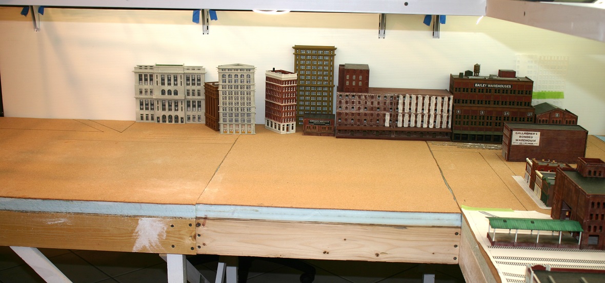

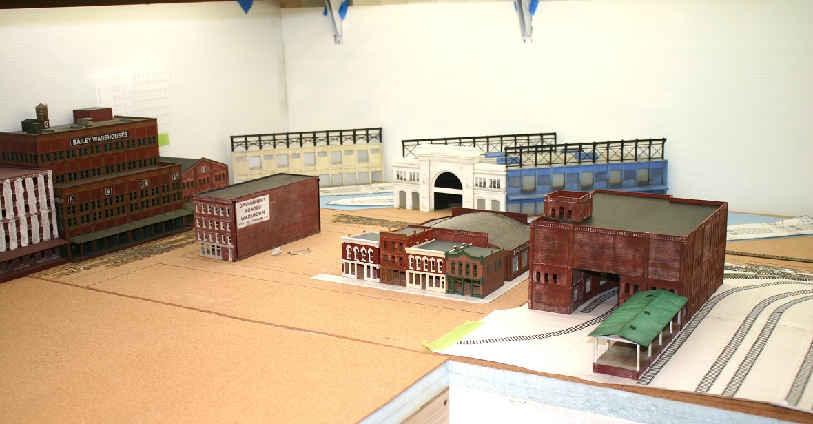

« Reply #220 on: November 18, 2023, 04:14:43 PM »
With the new job, progress has been limited. I have been working on some new buildings (DPM) that will go behind the Penn Warehouse & Safe Deposit as well as Durbin Paper from DPM Modulars.
I realized that when I built the actual modules, the sorting yard on module #1 was going to be too short with a train only being able to deliver 6 cars. So I built a 2ft module to extend #1 to 7ft long and now will be able to process a 14 car delivery. It will also allow me to add a scene that I had been trying to figure out if/where I could put it.
