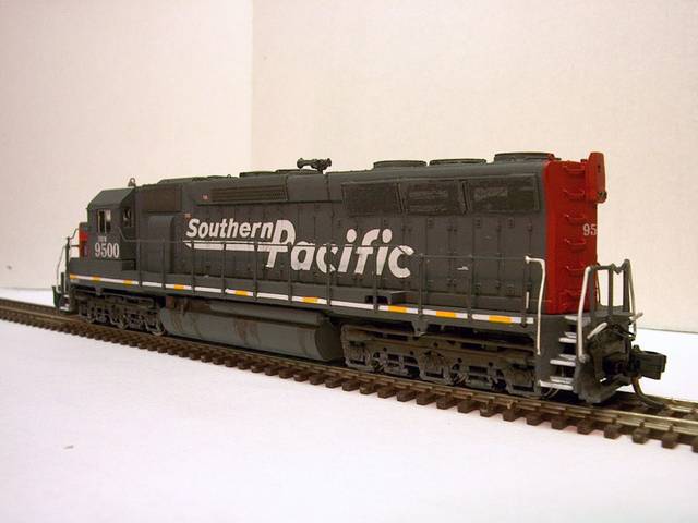

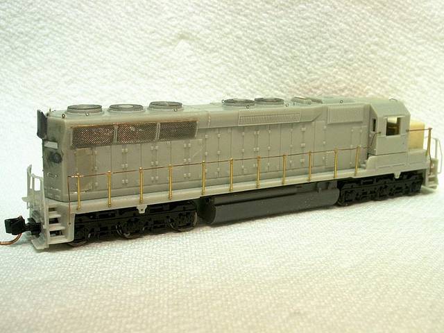

Result -
Unpainted -
They have held up very good. Notice however once you put paint on them, they don't look that much thinner than the nose and rear railings which I left stock. This is a Bachmann model, not a Kato though. Kato has a tendency to use very chunky handrails compared to others. The Atlas loco's are beter with IM having the thinnest factory handrails, but also the most fragile.

Wow, those models look infinitely better! That's some awesome modeling guys, I would've guessed they were HO and not N had I not known. Thanks for the help! ;D I'd also like to ask, what was the method of attaching the rails to the locomotives? It looks like you guys drilled holes into the shell for the wire, but how did you secure the rails and keep them from falling off?
It really depends on the loco. The SD45 had holes in the body for each stanchion already. It was just a matter of folding the end over and inserting it in the hole. I can see the Kato and Atlas loco's being more work as the handrails are molded to the sill. I haven't done one yet but I would first drill through each handrail on the sill so that spacing would match. Then carve off the stanchions and finish as on the SD45.
As far as the handrail to the stachion, I used CA. I didn't have a nice low wattage soldering iron at the time. Now that I have a 12w micro pencil, I would probably try soldering but CA has held up fine, including a drop to the floor once.
