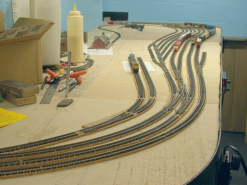

My plans are to have the town of El Dorado proper be elevated above and behind the yard by about 3"
There will be a track that leaves from the rear of the yard and loops back around to the backdrop and rise up to the town.
I have have at least two industries that will be located up on the town.  These will be worked by the yard crew during the session.  There may only be 0-4 cars that will need to be hauled up to the town.
In the pic below you can see the temporary loop on the inside of the yard that loops to the backdrop, but it's on the same elevation as the yard for now.  From the backdrop to the rearmost yard track, and from the mainlines in the background to the opposite end of the yard (not in the picture) needs to built up with foam.  The loop of track will be on the grade.
