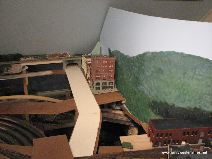

« Reply #645 on: April 17, 2012, 10:10:07 AM »
Repeat that third floor wall on the newspaper building to the left, and you'll be onto something.  I'll email the full size image to you if you like.  (I see a calendar shot!)
Re: WM Western Lines Engineering Report
« Reply #646 on: April 17, 2012, 10:44:26 AM »
That was just a "quickie" for giggles. It would be a lot easier if you re-shot it with the sky cardstock running all the way behind the full width of the station; it's a bear to mask along the edges of all those dormers. Also, if you could pop a little extra light in under the highway, that would be most appreciated as well.

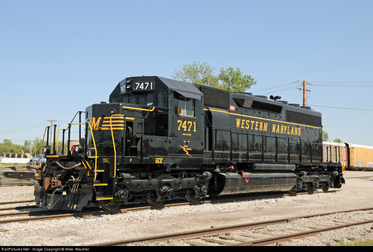

Did WM ever get SD40s in this livery?
  • Posts: 16583
  • Respect: +7502
« Reply #648 on: April 21, 2012, 08:46:45 AM »
Not only did they, that's one of the original ones.  After a long career for the WM, Chessie and CSX, this one went into lease service, and was recently purchased by the Georges Creek Railroad out west of Cumberland,  rebuilt, and was professionally restored to its original appearance.  It either is or will be shortly back in revenue service on home rails hauling coal down to the CSX connection at Westernport.
Ain't she purty?
I have 7471 in my roster, but apparently I haven't photographed it yet...  Here's 7495 in the same color scheme.

I did a little monkeying around in Downtown Cumberland...
I started engineering the first block of buildings to be installed there against the skyboard.  I'm working from the back wall out, now since once this is all closed up, I won't be able to access it at all.  I didn't leave much of a pop up back here, athough I can wiggle through enough to be able to do the scenery along the back and skyboard.  Everything else will be "flown in" from the aisle.  Anyway, here's step 2:
This is the foundation for the block.  It's a removable panel, which sits as close to dead level as I can get it, despite the roadways sloping all over the place.  The block of plywood in the back is the base of the highest building, and includes a 1/16" plywood lip that catches the roadway at the back.  This holds the whole operation level.  The threaded rod is the handle I'm using to pick it up and put it down while I'm working on it.
And with the buildings in place.  Having the tall building in the front, I can probably leave the threaded rod handle in place, and just paint it green or blue or whatever will be suitable to make it invisible.  I could always disguise it in a chimney or something.  You can see in this view how it relates to the industrial area and station around the corner.
Finally, the streetside view as the proof of concept.
I have to build on the foundation facades, and do some other detailing, then the sidewalk gets attached at the same slope as the roadway.  Then all the sidewalk details get added.  I'm in the process now of building the interiors and lighting for the buildings.  They will all be linked into one circuit for the block, with a phone jack pigtailed off to make for easy plugging in and out.
All this needs to get in so I can start working on the brewery.  There's a lot of tiny thirsty people up there in the hill country!
