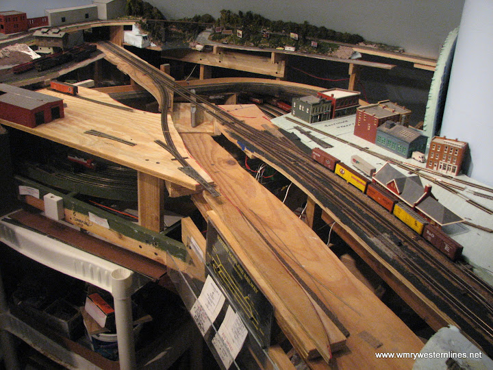

The next step will be to cut out some 1/4" plywood to make the structural base, and lower the grade to account for the foundation of the Cumberland station.  All the industrial tracks will be about 3/4" below the main line grade.  The B&O interchange track will be on a fill at the same grade as the main.
My plan is to build the city blocks as removable panels that can be detailed and dolled up with interior lights and details, then plopped back into the layout.
@wazzou, the industrial tracks are all close to the aisle, within easy reach.  Refer to the track plan below, and see Cumberland.  The only thing that's a bit of a stretch is the Thomas sub line across the back of that section.  But even that can be accessed from the aisle if the need arises.

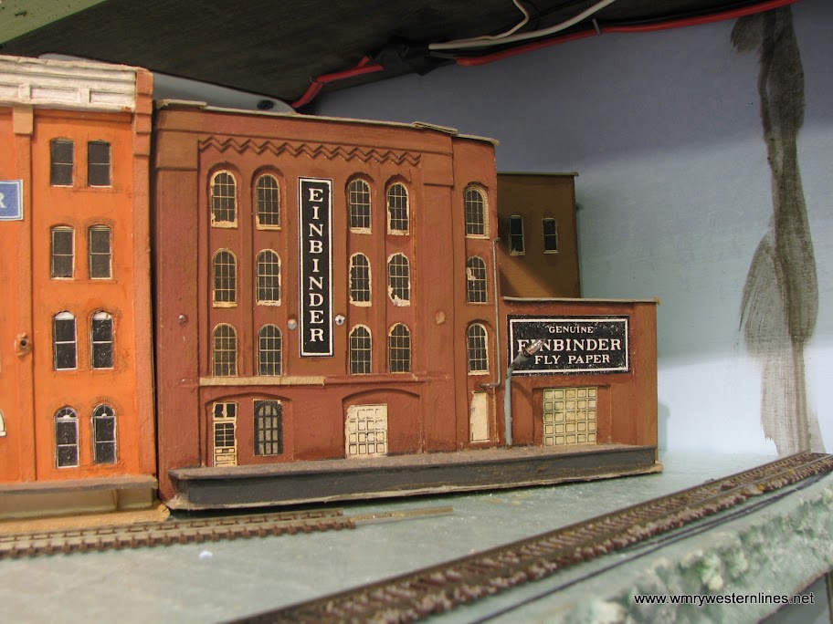

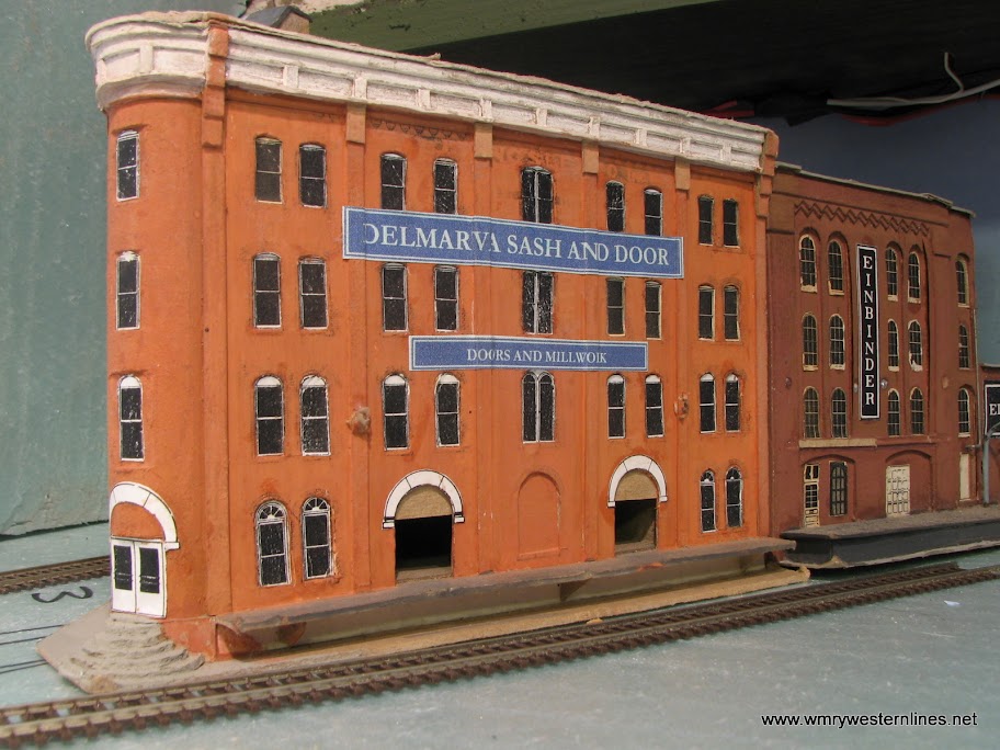

As promised, my ancient and venerable card stock industrial buildings...
They've spent much of the last 10 years or so in storage, before that they were on the Delmarva Club layout for a couple of years, but otherwise haven't seen any active carloadings since about 1993.
I used a cardboard tube from a roll of paper towels for the curved end of the orange building, and some pinking shears to make the zig zag brick trim on Einbinders.  Otherwise it was simply layering strips and shapes over a photocopy of the MR drawings.
The third building in the block was between these two, and you can see the facade in the background of this shot.
I'm debating whether I should "renovate" these, or just chunk them and start over with styrene.  I have a good supply of windows and doors and some Plastruct brick sheet, so I may be able to re-skin them.
I've got a couple of others, but they're in even worse shape.

I'd chuck and restart . . .

I think you'd be further ahead Lee by starting over.  They look pretty rough at this point.

I wouldn't chuck them, but maybe make them background buildings if you can. I think you'd need a little more detail since they'd be front and center at the location you were thinking of putting them,

The orange one is stable enough to be a core that I could re-skin, in the process I'd cut out the windows and add styrene windows and glass.  Einbinder's has definitely seen better days, and is likely headed to the scrap heap.  I will probably cut them back to be shallow flats and place them against the back drop as the industries, then scratch out the freight house for the front.
To keep it era appropriate, I may model the freight house on the big concrete block structures that were at Hillen.  Somewhere I've got a picture of that.  It had a big WM logo painted on the end of the building that would be way cool...

I think despite the age of those buildings and the deterioration, they look really believable...well done.
Oh and by the way, extra points to you Lee on Einbinder's for the Craft Scissor work on the facade.

Durn cool! They look really nice given what they are. If still on a shoe string they could still be useful until something more effective becomes accessible for ya.
