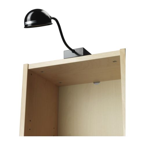

I was sort of kidding about the christmas tree lights . . . it all depends on the room you will have it in.  Easiest thing would be track lighting mounted on the ceiling overhead, wired to the wall switch.
With 4 or 6 track lights in the track, you could aim them to different parts of the layout.  Or, depending on how you build the backdrop, you could even add a couple of these from Ikea to the top of the backdrop:
This would be a supplimental approach.  If you wanted to go with Ed's light string idea you would need a valance - and if the lighting is that light (!) you could suspend the whole thing from chains run up to hooks in the ceiling joists.
