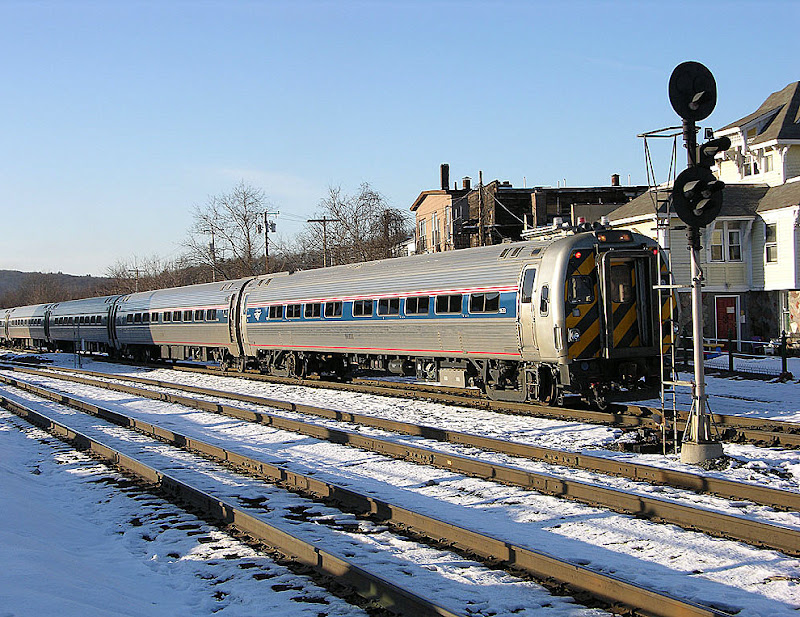

Ian, how did/does the Vermonter get into that station? Does it switch push/pull mode there as I assume it heads back out the other part of the wye to get to Amherst or is there another junction east of the station?
Phil
- Phil
Re: An extra day off leads to bad things
« Reply #66 on: December 27, 2010, 02:38:13 PM »
The Vermonter comes off of the Amtrak Springfield Line, makes its station stop at Springfield Amtrak, and then continues East on the Boston Line until Palmer where it makes its reverse move onto the New England Central. So Push/Pull mode switches in Palmer.  However, there are talks about rerouting the Vermonter back to its original route using the B&M Connecticut line (the north part of the wye on the track plan) using DOT Tiger funds. Work is already underway for this route change in VT with CWR being installed this spring. Trains would come up the Springfield Line, cross over the diamonds of the Boston Line, back down to Springfield Station for the station stop, and then go back out on to the wye, north on the B&M CT Line.
In Palmer

Interesting, I thought Amtrak poo-pood back-up moves like that?

Dunno, they've been doing it that way since as long as I can remember! I guess sometimes lately they have been running P42's on each end, no cab car.

You know, the more I think about it, I think it is more on those trains that don't have the cab car also on it, like long-distance trains,
