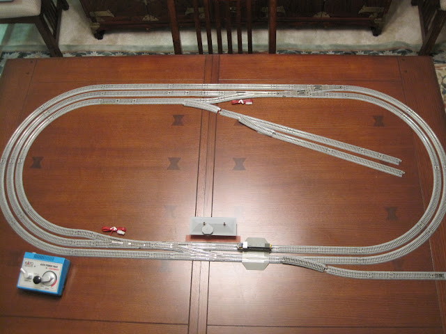

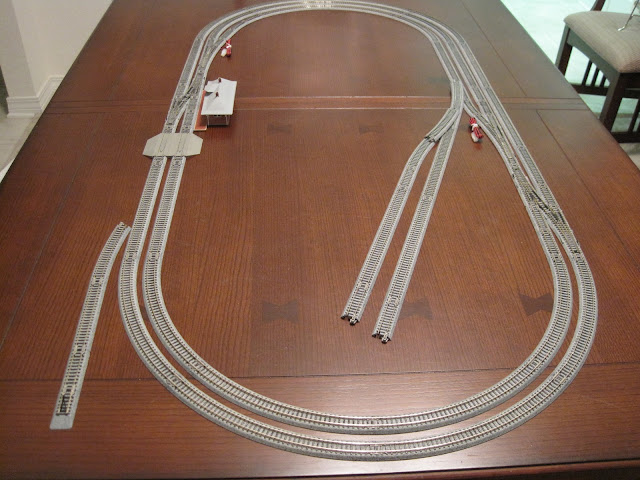

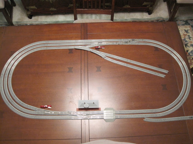

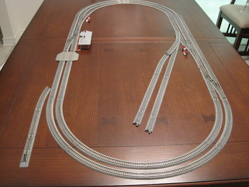

OK, so we did some planning.  Still need 3 more turnouts (#6 RH) and two bumpers, but otherwise are good to go.  You can see that I've attempted to represent those turnouts with some loose track.  The good news is that the geometry works.  The bad news is that I'll need to extend the table a few inches past 5 feet long if this is to fit.
Plenty of room for the town of Apex and scenery.
This will be a fun little layout!

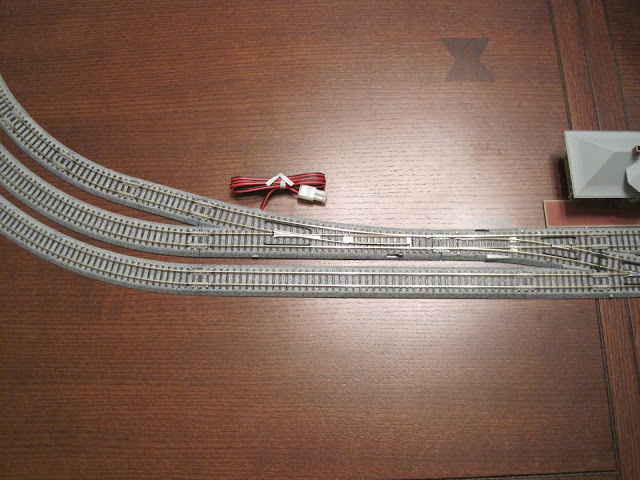

Was trying to figure out why it grew longer. From the photos, it looks like the culprit is the track coming off of the switch at lower left inside corner of the plan--

« Reply #64 on: January 02, 2011, 07:41:27 PM »
Dave, you're right.  That was it!

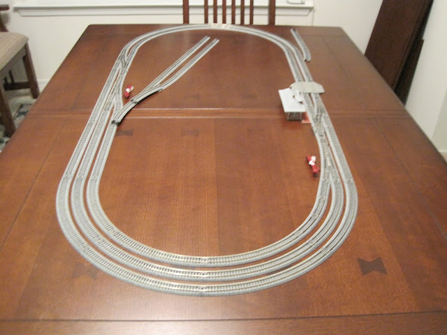

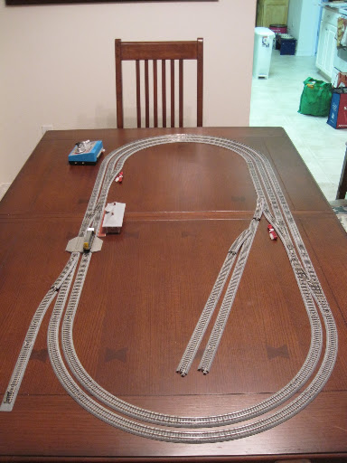

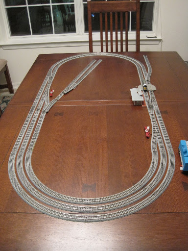

« Reply #65 on: January 02, 2011, 08:37:32 PM »
Okay correcting the problem in the lower left to match David's plan makes the layout considerably less than 5 feet long, which is perfect.  Moreover, it provides smoother geometry into the passing siding.  The downside is the geometry looks a little strange, but that's the limitation of Unitrack.  I will say, though, I love how quickly you can make changes and test new arrangements.  I haven't had this much fun with track since the boys were into wooden Thomas.
