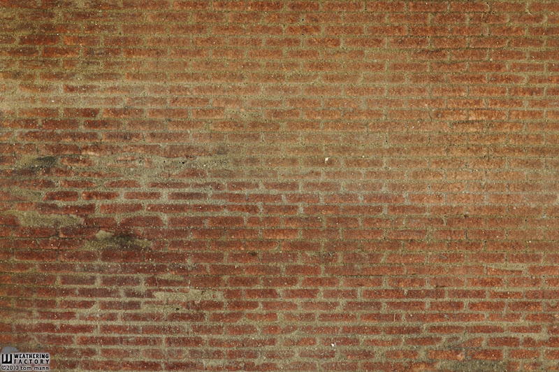

Well, here is what I have so far:
Maybe too much raw umber?
Maybe now, but not once you add more single brick colors.
Given the wide variations one can find in life, I'd say probably not, unless you had something specific in mind. Quite nice as it is, IMO.

Judging from this photo, the color is quite convincing, especially for a dry climate.
That said, my first impression was that there was a fair bit of schmutz (grout residue) on the bricks.  But that may just be accentuated by the extreme close-up; it could work quite well in context.

I think its perfect for aged brick.
That actually is the result of rubbing the grout residue off and causing some color to be wiped away from the plaster.  Maybe it is best to seal the brick before the grouting?  Maybe.
