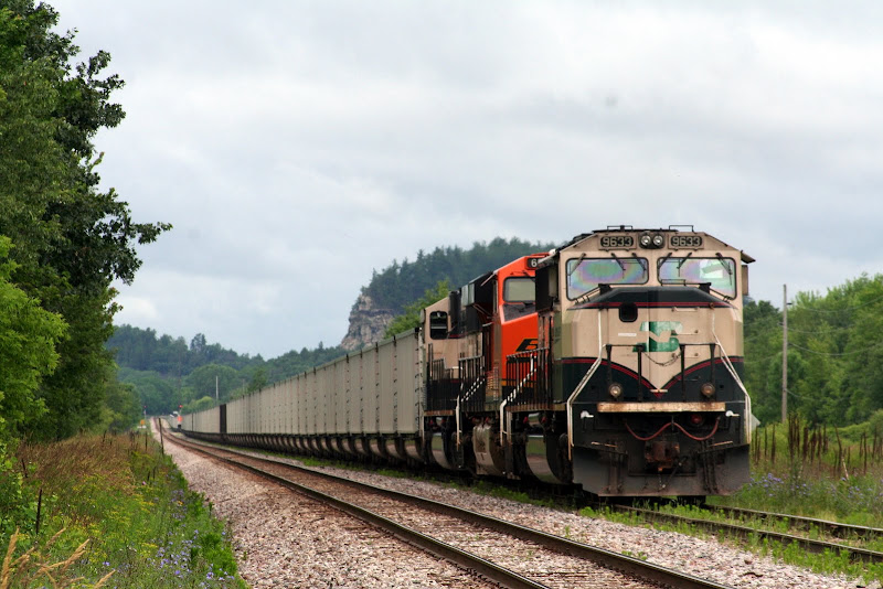

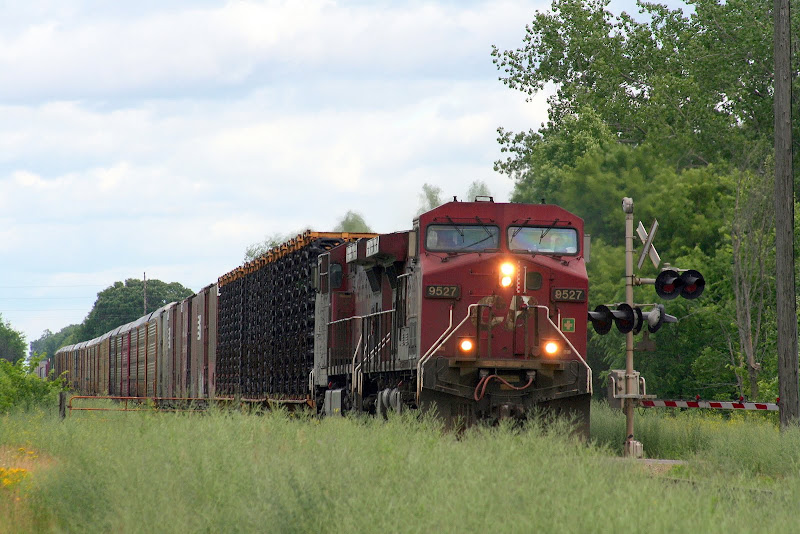

Re: Any MiNi Mod-U-Trak Photos from the NMRA show?
« Reply #58 on: July 27, 2010, 09:45:40 AM »
My only thought to the contrary is that maybe the grass base scenery is a little too uniform...  Maybe it's just cause I'm an unwashed east coaster, but to my eye there should be some more transitional colors and textures, particularly around the urban stuff.  Looks a little too clean.
It looks better in the photos too me as you can see the color and height changes. The video is really nice but washes out some details. To my eye from the photos and the videos it is spot on for central/western WI, having spent most of my teen years out there from May-Sept.
New Lisbon
Camp Douglas
Tomah (@ Tunnel City)
Russ Porter photo that I used for inspiration on the Newport corner:
