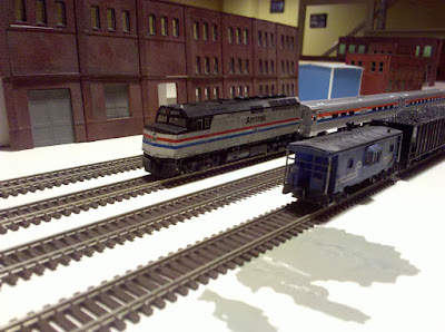

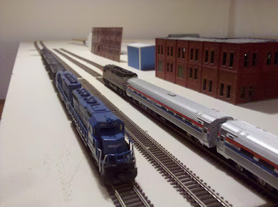

I agree 100%, staging is absolutely critical, but I don't think it has to be traditional staging.
On my current basement plan, I'm including 3-4 tracks worth on the back side of the layout, where it's still quite accessible, but that space is ALSO going to be doing two other jobs:
1. Scenically, it's giving me a chance to FINALLY build something that looks like the NEC.
2. There's going to be an industry off of one of the tracks. Yes, this seems annoying to get to, but so is trying to switch off the NEC. Gotta watch out for the 100mph meatballs!
