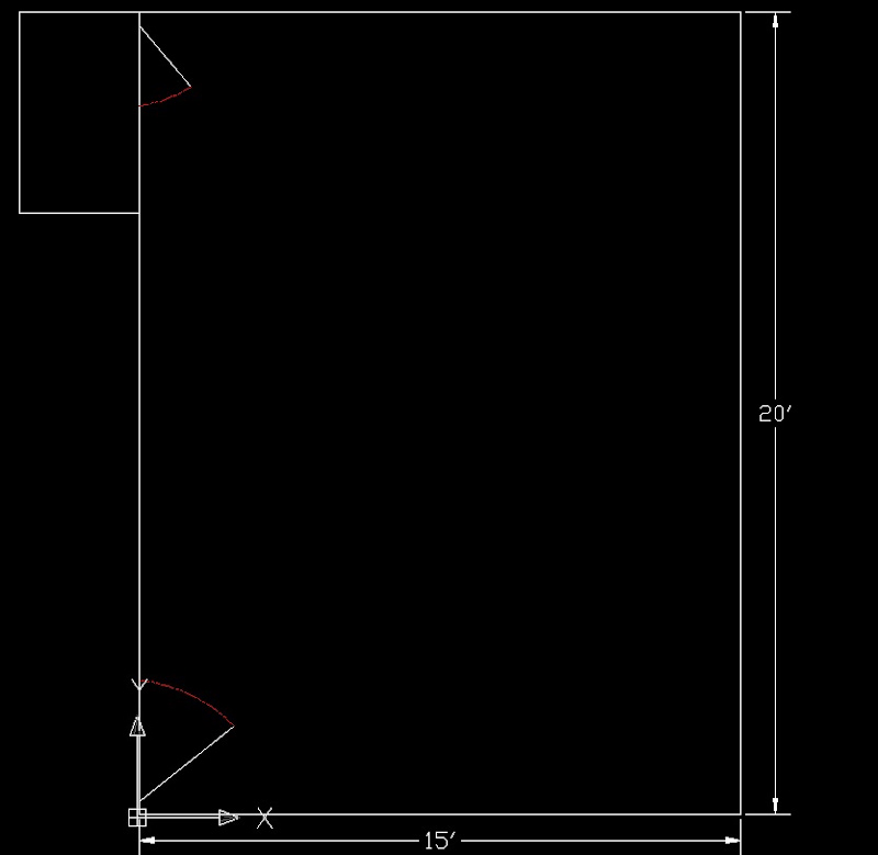

The above is the bedroom in the new apartment I'll be moving to come June (I'll put my bed in the living room).  I'm thinking about two layouts: one between the entrance and the closet, the other around the other three walls.  So, figure a door layout on the one wall, could I get y'all to design me some basic benchwork and a point-point mainline (I'll try to figure out sidings and such like later).  I ask because I have had this much space for a layout before, and I'm slightly intimidated.

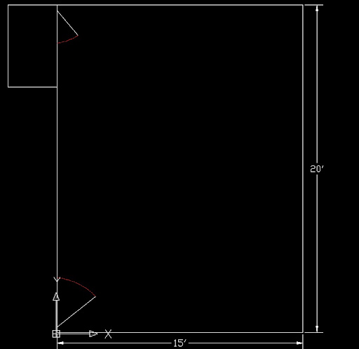

Ok, this is what I've come up with so far.  Opinions?

looks a little close at the door.
That said, you can get some good, long isnuous scenes in there.  With a low back frop or scenery divide you could even squeeze in a narrow staging yard at the back, connected at both ends for continuous running.
What scale/gauge wer eyu thinking?  Minimum radius?  Track code?

I wouldn't try to fill the space at first. This is an apartment which means you won't be there forever. It also means that you have neighbors who don't want to listen to a bunch of construction noise. So think modular for when you have to move. I would keep the bed in the bedroom and start modest with a door layout. Nobody wants to see a bed in the living room when they visit. This space is big enough for both.

I have to agree with Dave.  Keep the bed in the bedroom.  The space it would take up in the living room would be fine for a nicely finished modular railroad.  If you are "entertaining" female company, two turnoffs would be a bed in the living room and trains sharing space with the bed in the bedroom.   ;)  You can do the noisy and messy layout construction off site and your neighbors and landlord will be happier for that.
How much space were you going to allow for the bed in the living room?  Use that for layout space.  The layout does not have to be N-trak style modules, but something that can be easily moved and expanded when you have more space.  Having a nicely detailed, finished and manageable layout in your living space sounds like the best option.  Just my opinion.

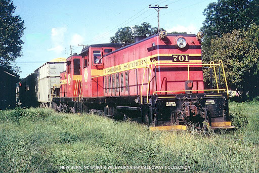

The reason I'm really wanting the long runs is that NS was characterized by a whole lot of 'nothing.'  Iconic views of NS include the following:
Since I want to model the eastern division, I have to have at least a representative Albemarle Sound trestle (no way I could do the whole 5 1/2 miles, even if I had space; I couldn't do that many bents).

As I stated, I am a proponent of doing a highly finished and detailed layout in the living room.  That being said, if you are determined to build a layout in the bedroom I can see a couple of problems.  There are going to be access issues in the two corners and against the wall at the end of your penninsula based on the benchwork footprint that you posted.  If you are determined to put the layout in the bedroom, I would suggets 18" to 24" deep shelves, cantilevered from the wall and placed at about 52 - 53 " above the floor.  That will leave the room underneath available for furniture, etc.  You will need to patch and paint the walls when you move though. Kind of like what I did with my Housatonic RR layour in our bonus room:

The backwards E is not a good idea. The good old linear around the walls with a peninsula in the center is better for running, staging, etc. Easy to build in sections that can be transported when you move on so long as you plan it that way. Doors can be removed, duck-unders are not fatal. Don't worry about visitors, they don't have to live there.
