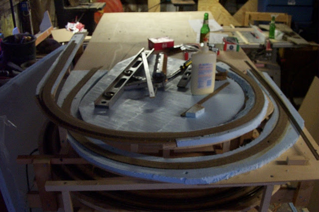

I have 14 inch curves (or rather I have my first 14 inch curve) laid out, and while the longer cars do look . . . interesting going around them, if you lay your  track carefully you should be fine.
