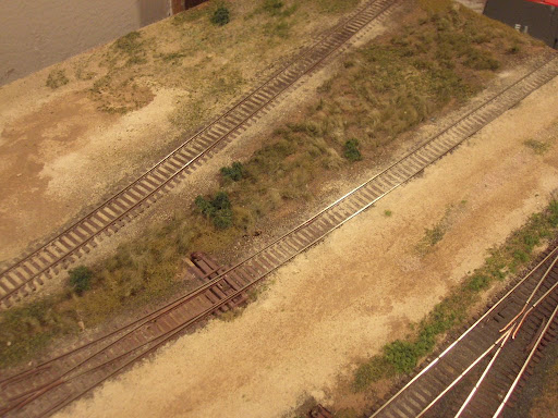

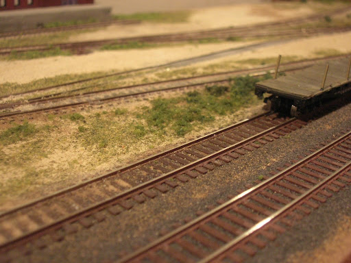

No need to apologize! It was brought up on page 2.  I use two colors of Polyblend, "Fawn" and "Camel"
I'll have to get a better shot, but in this scene you can see the "Fawn" by the water tank and in between the siding and main line.
I learned to get a few shades darker than what the color swatch on the label is as the grout is a bit lighter than what it states.

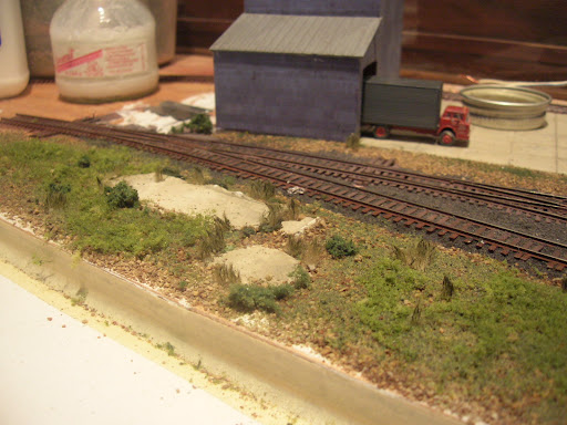

I do a kind of zip texturing, using grout.  I slap on white glue, full strength, and brush it smooth.   Then I use a pantyhose to sprinkle on the grout.  Once I have it on heavy enough, to the point where you can't see the glue come through, I put a piece of paper over it and smooth it all out with my hand.  Then gently lift off the paper.
I end up with a textured, but smooth finish.   After that I sift on various other colors and ground foam.
On weedier areas, I simply apply my foam on top of all that.
