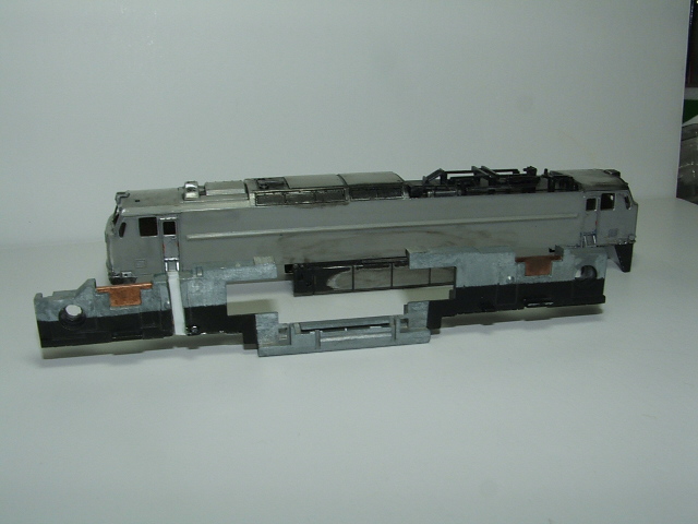

Modding atlas 8-40C mech to fit AMTRAK GE E60CP
« on: March 07, 2010, 05:14:41 AM »
I thought I'd have a crack at a North Eastern locomotive, so I acquired a Bachmann AMTRAK GE E60CP. I got this free and it was kinda stuffed. Missing a truck and the contacts on the remaining truck were really bent out of shape.
I've nearly stripped the shell and I have biffed the Bachmann mech in the garbage.
I have a few Atlas 8-40C locomotives so I have sacrificed one just to see if it would fit.

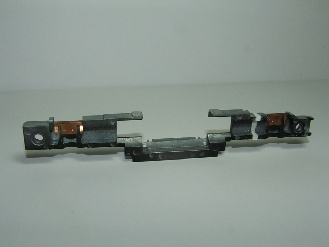

It needs a lot of milling to make it fit and it needs to be lengthened a bit.
So here's some pictures of one side partly extended.
Notice that a huge chunk of metal is missing from the top where the lightboard slots in.
Somewhere on this forum or Atlas is Daniel Leavitts thread about improving the Bachmann E60CP but I'm buggered if I can find it, I also checked trainboard too.

Yes you can use a U30C / C30-7 mechanism, but mine are all under working models and I only had the Atlas 8-40C to hand. But it is so much more fun to hack up a brand new mechanism and see what can be done with it. You also get the modern slow speed motor etc.
Just think I get to mill the frame, drill and pin the styrene inserts and make a styrene clip for the top, extend the drive shafts - mmmmm fun!! ;D ;D ;D
