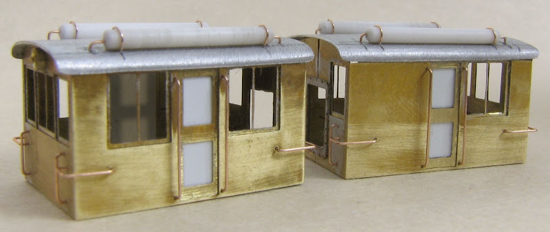

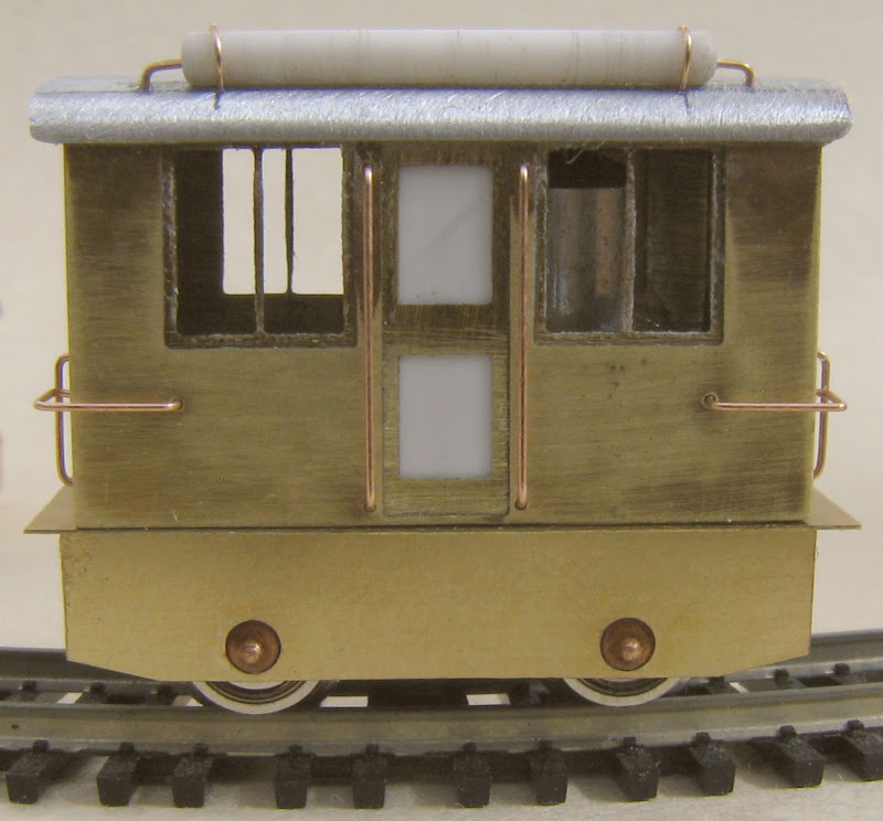

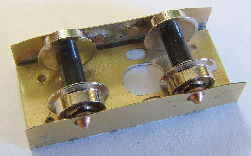

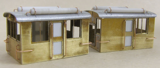

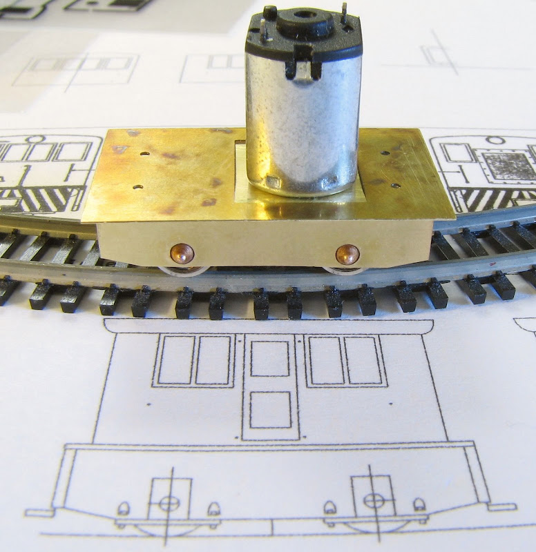

I shook my head real hard and the Nn3 bubble rose to the top.  ::)  So I started making a pair of Nn3 23Ton GE boxcabs. This is a mock up of the frame:
The bodies:
They will both be powered and wired together. Also if it works I will use an electric flywheel in them. Got the idea here:
I later found out that only 11 20-23 ton GE boxcabs were built.

Chris, the boxcabs look good.

Chris, that looks like a neat project. It doesn't seem like we're too far away from axle-mounted traction motors in N, with some of the stuff you guys are building. :)
Could you share some of the details on how this works? I assume it's capacitor-based. I've been considering building something like that into my end-loop module, to make cutting power to a block a little less of a traumatic experience...

It is a capacitor 5.5V .047F :
http://homepage1.nifty.com/tfw/5012,5013/5012,5013e.html
I'm pretty sure for it to work you can not go past 5.5V. This will work for me because the gear ratio is so low (20:1) that I won't want to run it very fast. It should run just like this:
I think if more than 5.5V is applied the cap would blow, yikes!
More than likey if I ever built something for this to run on, it would just be a small roundy round loop. I might even run it off of batteries.
