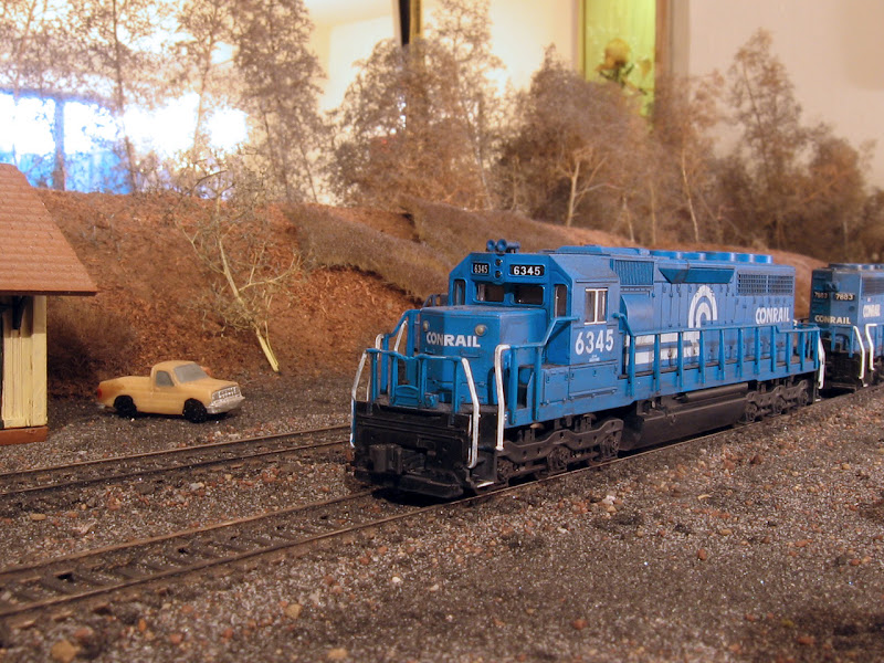

Anyway, back to the ballast topic. Here are some highball cinders I just kinda sprinkled around. Greenery still to come:
It's still a little to textury though for what I'm going for.

Frankly, the model shown looks like there's giant blobs of popcorn all over the right of way.
That's more or less what I'd said, although not quite so "colorfully."
...Here are some highball cinders I just kinda sprinkled around... It's still a little to textury though for what I'm going for.
Ed, that's looking really good. Perhaps if you added some very finely-ground material (almost powder) and brushed it into the existing ballast--especially making sure to fill in the voids along the inside of the track, below the rail (you can see some ahead of the loco)--you might end up with what Tom needs, albeit much darker. I'd also take the time to strip away anything stuck to the sides of the rail, as well as carefully remove any material piled on the tops of the "spikes."
That pickup truck is sure a sad-looking specimen, though...
