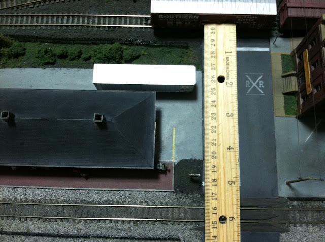

Dave, what are the dimensions, particularly width from platform to rear of baggage section?
Overall dimensions (excluding any platform that may extend beyond the roof): 6.25" wide x 5.25" deep, that is from the front edge of the roof to the rear of the baggage section.
Problem? Speak now, I can make adjustments easiest at this stage.

That depth may be more than I have to play with without some surgery...
Re: PRR/Conrail Juniata Division Engineering Report
« Reply #643 on: August 21, 2012, 12:20:11 AM »
Dave, I can do one of two things that may help. One is to graft the baggage room right onto the back of the station. The other is to omit the baggage room altogether. Your pick.
EDIT: One question for you: Do you have any opportunity to "excavate" about a quarter of an inch or so from under the station, so that the freight dock on the end is at truck height? If not, then I would simply slice off the entire foundation and simply do without. Another option is to raise the station platform a fraction of an inch higher so the station can stand a little taller, which might afford a halfway-decent freight dock area.

Dave,
I can excavate...  Getting the base level might be a challenge, though.  The station sits on one layer of Woodland Scenics trackbed over 2" of foam.
I'd really like to keep the baggage section...  Can we graft it?  Looking at the pic if I could gain maybe a quarter inch all would be well.
