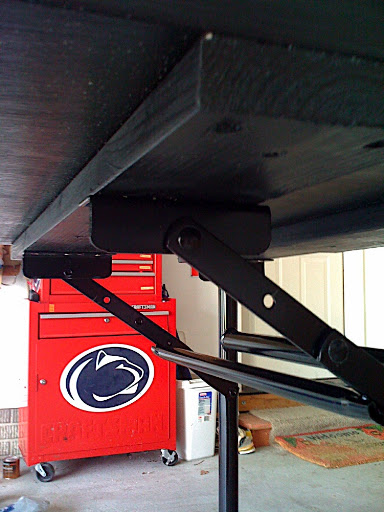

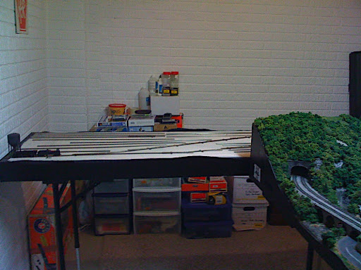

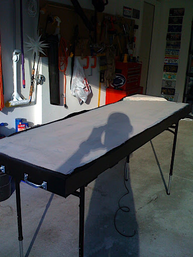

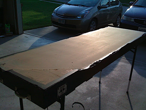

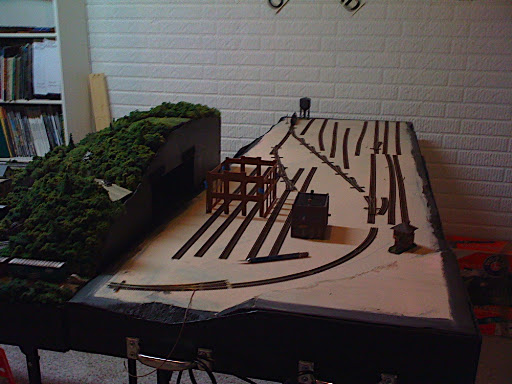

Sorry about the quality; I'm using my iPhone since our good camera is broken.  I started construction of the yard extension for the N scale Juniata division.  The extension is constructed the same way as the existing layout; a hollow core door topped w/ 2" of Styrofoam with folding/telescoping H-shaped table legs.  The fascia is 1/8" tempered Masonite hardboard painted semi-gloss black.  I'm test-fitting the tracks; don't get too hung up on the arrangement; it's not 100% done yet.  The backside of the mountain will be covered with a removeable 1/8" Masonite backdrop mounted against the old layout with industrial-strength Velcro (for tunnel access).  You'll note that I'm using Atlas code 55 this time instead of the code 80 used on the previous part.

Is that an Atlas curved turnout Dave?
  • Posts: 12401
  • Respect: +11983
Re: Weekend Update 7-12-2009
« Reply #23 on: July 13, 2009, 07:52:20 AM »
Steve,
Nope...  Fast Tracks.
