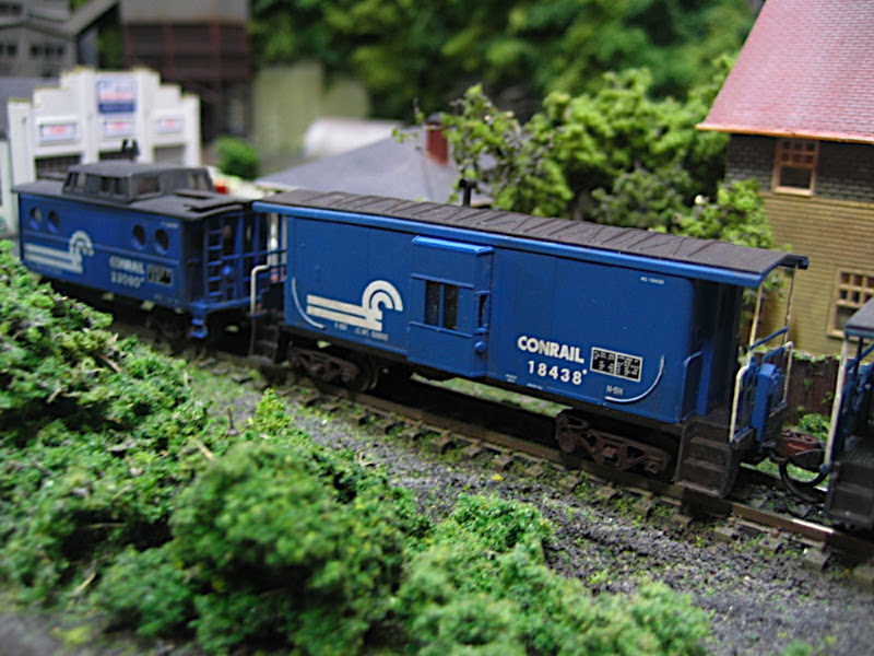

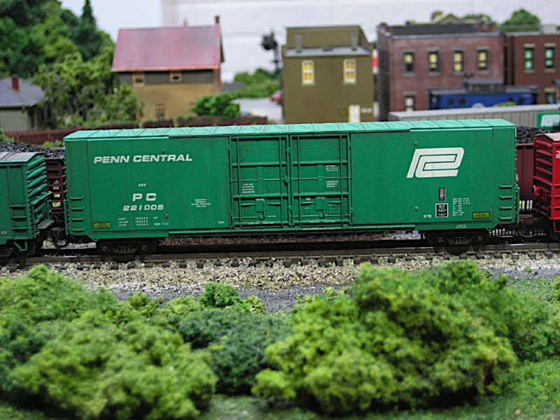

Okay, did a little work.  Filing down the bolsters helps:
I painted the end post and railings white and also added some weathering using acrylic washes after spraying the car with Dullcote (mask the windows first!).  Some FVM metal wheelsets cure the pizza cutter problem:
She still rides high, but much lower and we'll start having swivel problems with the trucks...

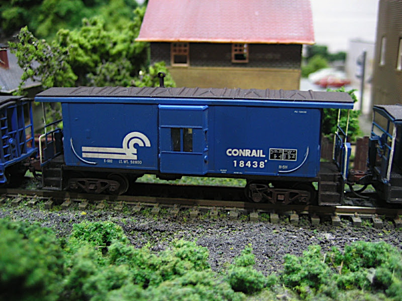

Also added ACI labels and weathered the X78:

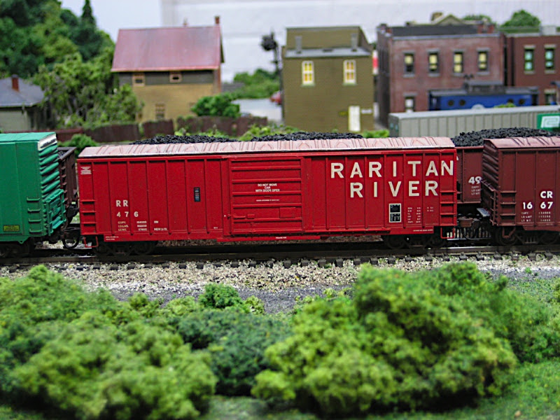

Also nabbed this Raritan River car at a train show for $5!  I weathered it with subtle washes.  CR took over RR in 1980 and got their 100 Sieco boxcars with it, which are a near exact copy of the Athearn car:
