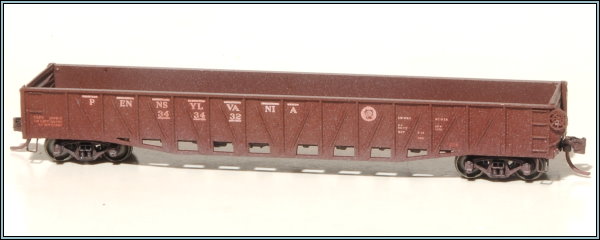

I took the more drastic approach of cutting the stock floor out of the shell, and filing out a little swing space on the ends for the truck mounted couplers.  I then lowered the shell as far as it would go over the frame, then used a piece of v-groove Evergreen siding, I think it's .015 thick, to replace the floor.  A little weather, and bah-BOOM!
No modifications to the frame were necessary, although in reviewing the photos, I see I need to move the stirrups from the top of the frame to the bottom.
Your car looks fantastic in the eye level photo.  The only issues for me are that the top of the floor no longer matches the rivets on the sides so the car must be loaded at all times, and that body-mounting the couplers (using 2004 knuckles in a 1015 box if necessary) would have eliminated the need to remove detail from the bottom of the ends.
This is the MTL gon I lowered for the N Scale article.  It easily could have been lowered further if desired, but my goal was to basically get the top of the floor to as close a prototypical height over the rail as practical.
