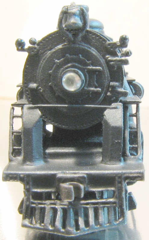

I use MV's. They are just epoxy with chrome foil on the back.
This is one in a Z scale loco:
