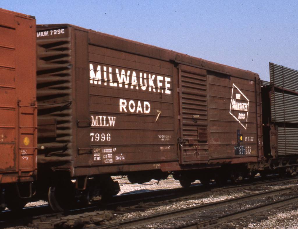

They allude that something is wrong becuase there IS something wrong, your ends lack the bevels and fillets that the real ones do... here's some more 5/5 Dreadnaught ends manufactured by Standard Railway Equipment...
Several different types of ends were used on these cars.
There are only two types of early Dreadnaught ends (before the change to the Improved Dreadnaught)... the difference being that in 1940 a change was made to the corner post, this had no affect on the design of the end corrugations though (it's affect can be seen of you look at the side of a car, as the end wraps around that new corner post... so the side is not flush as it was on the earlier style, but a semicircle before termianting at the side) The later syle is seen on the MILW rib-sided cars with the ribs not terminating at the ends, before the switch to the 4/4 Improved Dreadnuaght end.  The earlier style of 5/5 Dreadnuaght end was used on the long rib cars.

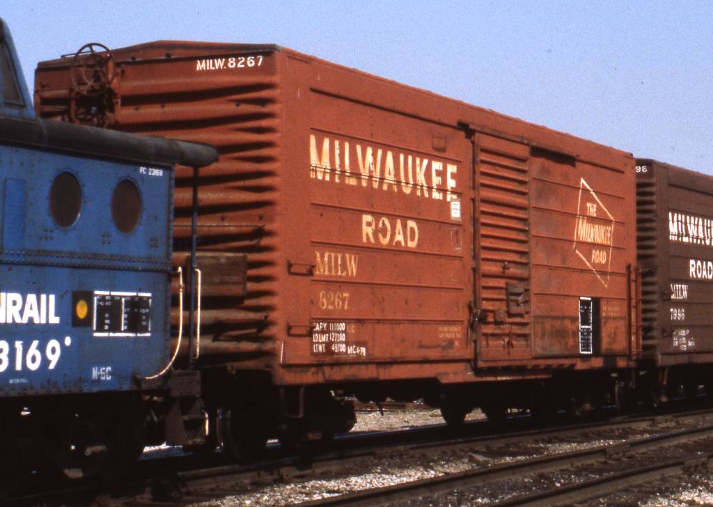

The ends are a little disappointing.  They must have used Intermountain's HO scale drawings to cut the dies.
Intermountain car has entirely different end:
How do you even come up with these comments?
