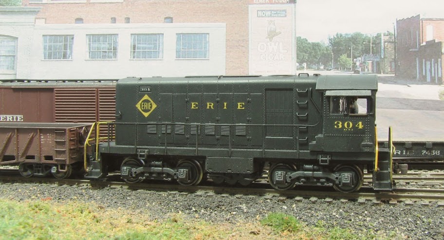

That loco in the photo is a HH660, it runs like this:
/>The 44T is not out yet. I also have a NW2 and boxcabs in the works.

Chris, I know the HH mechinism is still being fine tuned, but have you tried putting the blunt sideframes on Kato SW trucks? They may yield betterresults. The harbor scene is really taking shape.

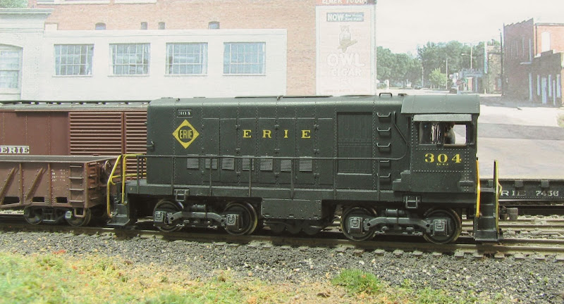

The HH660 is done:
http://lh5.ggpht.com/_rokQinu49Lk/SECUiQXHs6I/AAAAAAAAEjo/K_SrQV218Mk/s912/IMG_5912.jpg
The main reason I kept the S2 trucks was the way they plugged into the S2 frame. I shortened the frame and the circuit board, so everything works like stock. I don't even know if the Kato wheelbase is the same, but no I didn't try it. The HH660 runs much quieter now, the body if full of lead and it is a brick!

Link comes up as not found .
