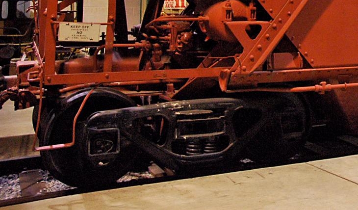

Should the stirrups be rounded off as much toward the body. I though they looked more angular in the drawings. Still looking great though.

Should the stirrups be rounded off as much toward the body...

Chris, they should be more angular. This was a deviation to make the stirrups more rigid and survivable. The sharp angle (in Bambuko's photo) would have made a stress point where the stirrup could have bent inward from inadvertent pressure. The curve relieves the stress and makes the .010 stirrup amazingly strong. In fact, I was pressing down on the body which rested on the stirrups (not thinking late at night). When I realized what I was doing, I expected them to be crushed. Instead, they did NOT bend or deform.
