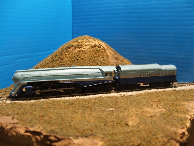

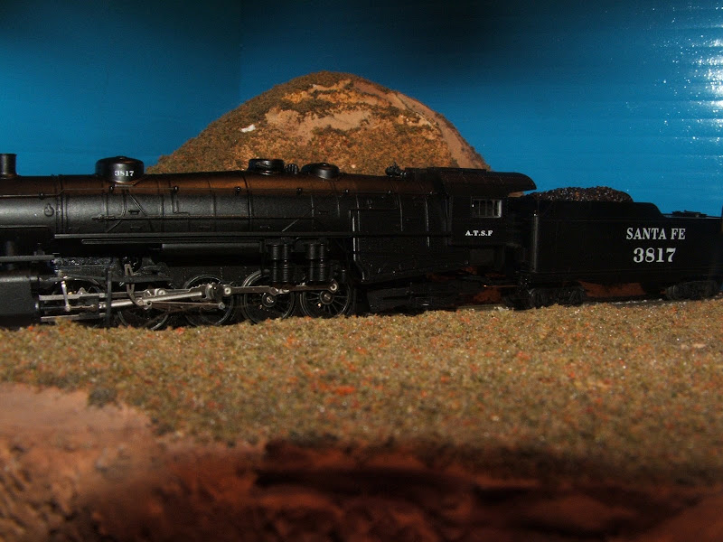

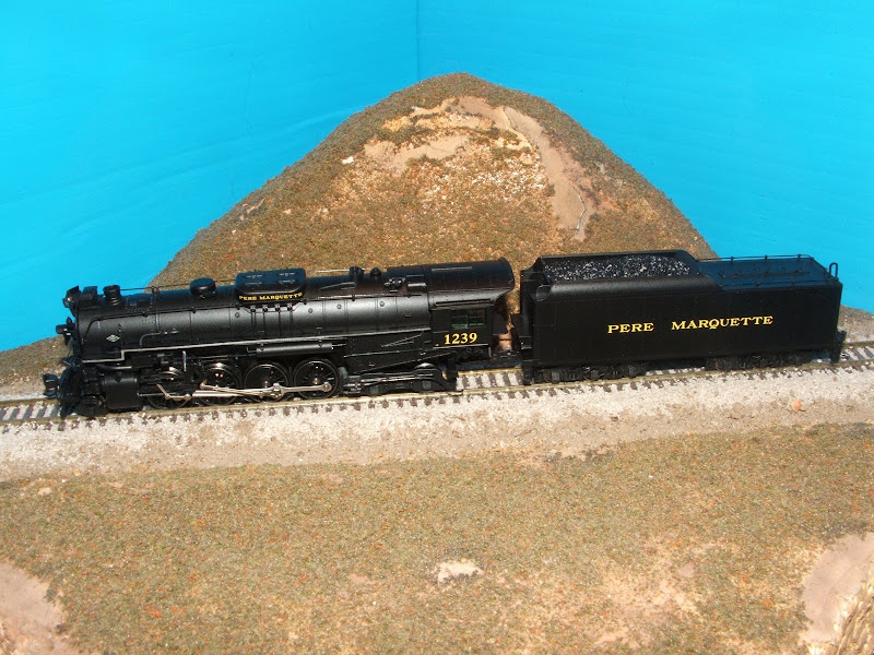

Remember how these look, they will be changed a little ;D

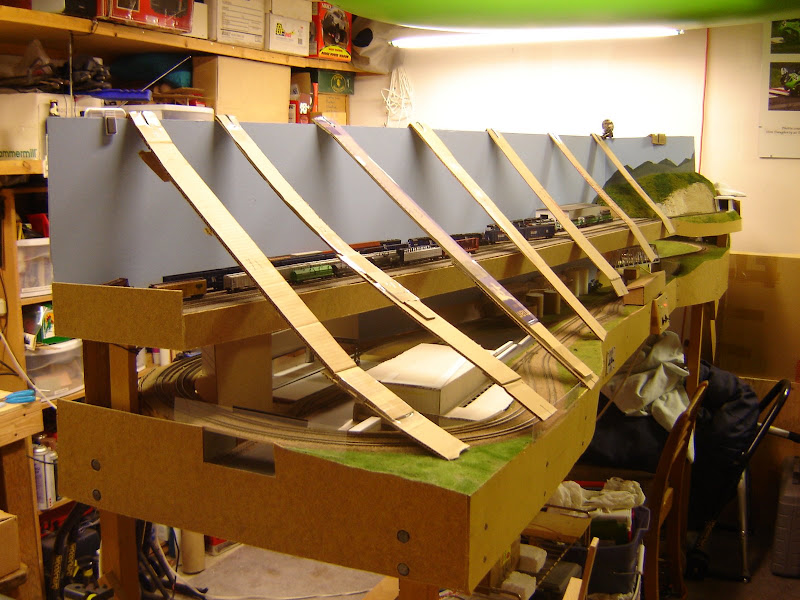

This weekend was the first time in a month I've been able to do anything train related.

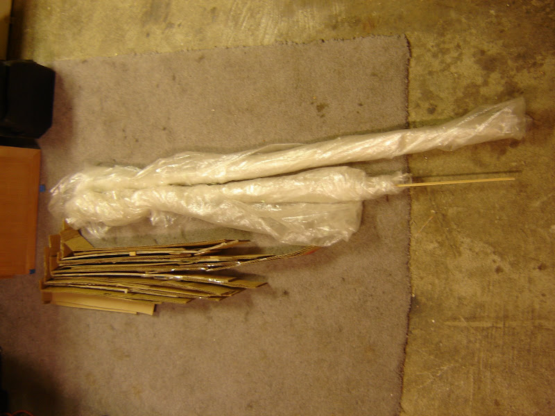

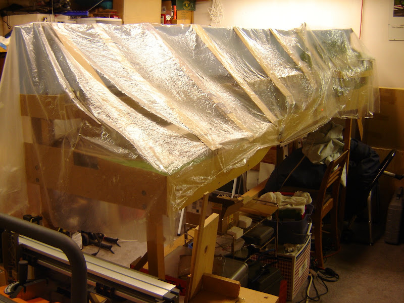

I've been doing some woodworking/cabinet building in my garage where the layout is located so it's been covered in plastic to keep the dust off it. I spent some time on the cover this weekend adding dowels to the edge of the plastic to help weight it in place and keep it spread out so gusts of wind don't blow it off. It also makes rolling it up for storage pretty easy. As you can see the cover and cover supports don't take up too much space once they are all off.
Covered Layout:
Cover supports that keep the plastic off structures and trains:
All folded up for storage:

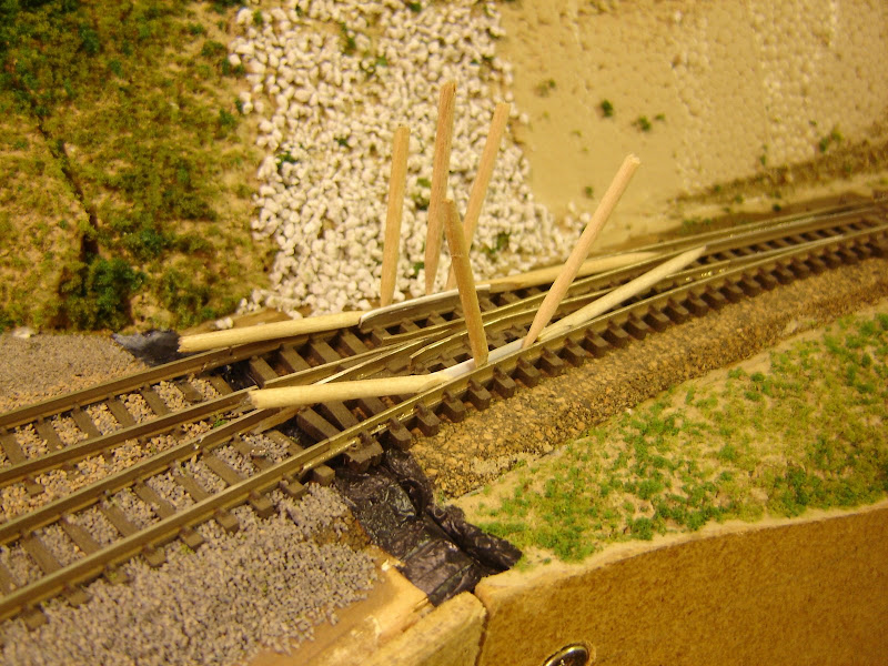

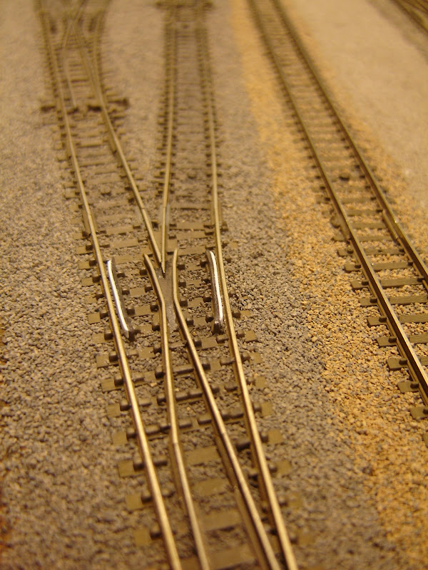

I also spent some time on track work. I've had derailment problems with certain engines and cars for years and I've always know the fix was to shim the guard rails on the peco turnouts but for some reason I've never done it. Well no more! I shimmed most of the mainline turnouts and engine facility leads and I'm kicking myself for not doing this long ago.
Shims being glued in place:
Finished turnout, just needs paint:
