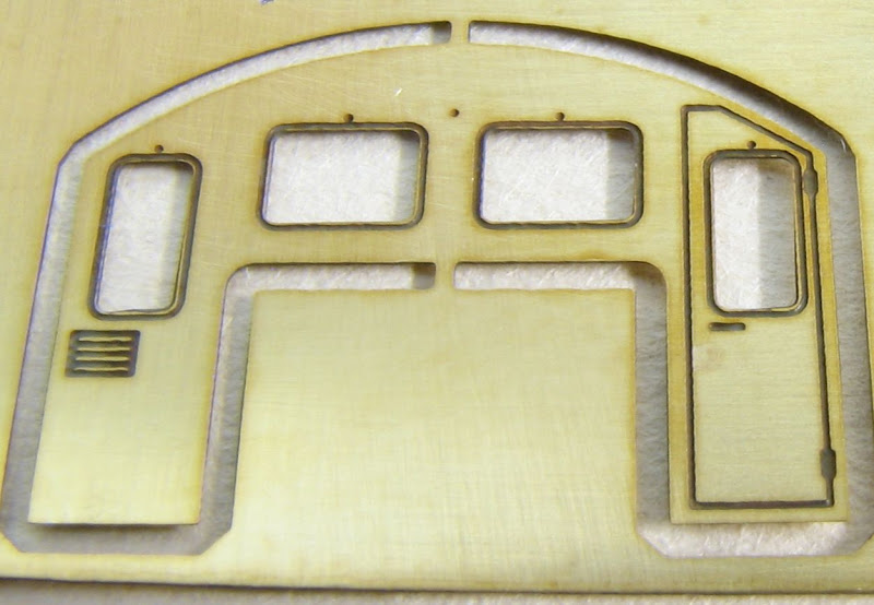

I thought it would be appropriate to honor this great event in N scale, so I contacted a friend of mine who's proficient with etched brass, who whipped up a cab front overlay that would fit on an Atlas N scale shell...
Once I received the part in the mail, plans for the surgery were set in motion...

i was wondering if your friend can do some detailing parts for my fleet. Please let me know if he will be able to help me out, or what etching products didi he use to create your super detailed parts.
  • Posts: 16587
  • Respect: +7511
Re: Chopper In Progress...
« Reply #13 on: September 09, 2008, 06:44:14 PM »
Well... he's down in the dungeon chained to the CAD computer right now.  I'll ask him next time I throw him a crust of bread...
What are you looking for?
