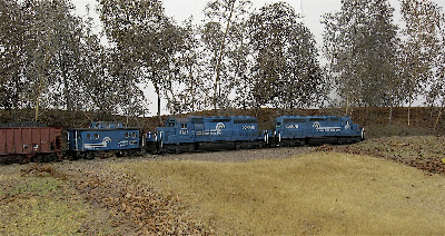

Building a portable layout means that I don't have a permanent backdrop, so I recently repainted the walls of the train room a nice pale blue color:
which now gets me results like this:
I'm pleased with the outcome, and, if need be, I can slide the layout around to avoid any visible wall corners, doors, or the window in the background of a photo.
